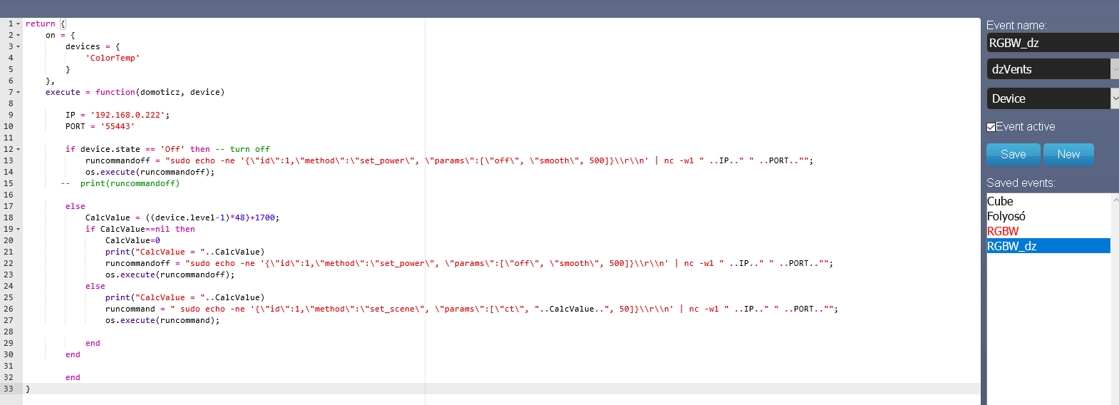

		devices = {
			'ColorTemp'
        IP = '192.168.xx.xx';
        PORT = 'xxxxx'
        if device.state == 'Off' then -- turn off
            runcommandoff = "sudo echo -ne '{\"id\":1,\"method\":\"set_power\", \"params\":[\"off\", \"smooth\", 500]}\\r\\n' | nc -w1 " ..IP.." " ..PORT.."";
            os.execute(runcommandoff);
       --  print(runcommandoff)
            CalcValue = ((device.level-1)*48)+1700;
            if CalcValue==nil then
                CalcValue=0
                print("CalcValue = "..CalcValue)
                runcommand = " sudo echo -ne '{\"id\":1,\"method\":\"set_scene\", \"params\":[\"ct\", "..CalcValue..", 50]}\\r\\n' | nc -w1 " ..IP.." " ..PORT.."";
                os.execute(runcommand);

I imagine you changed the events from Lua to dzVents
and set it to Device, like the image above
