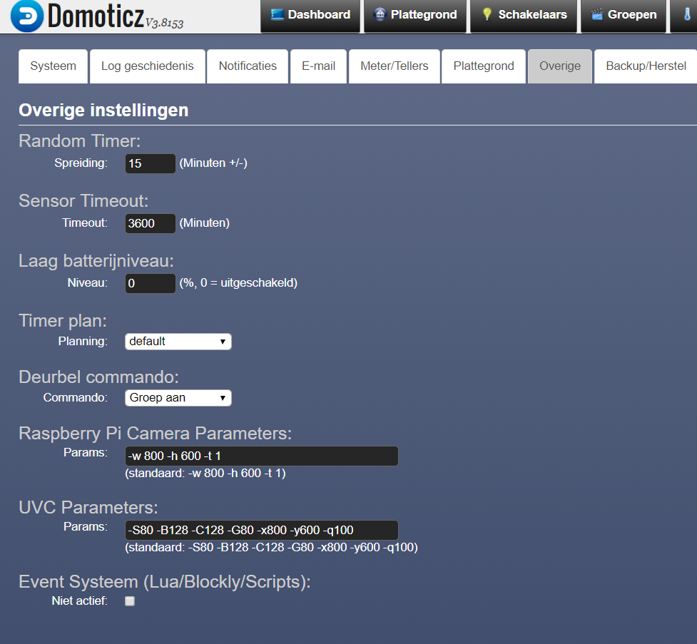

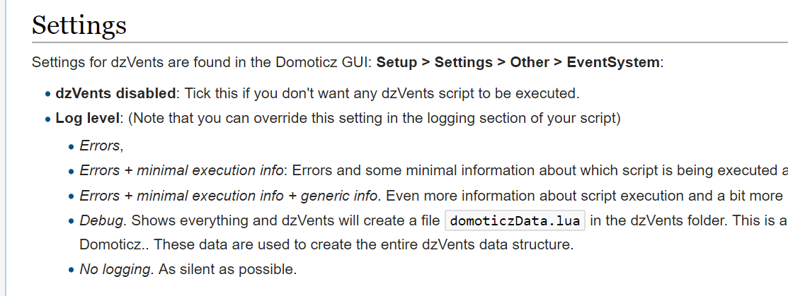

I use Domoticz V3.8153 and can make dzVents scripts. Unfortunately I have no logging. The dzVents Wiki says that I can enable logging in the settings:
In my settings there is not such an option.

There should be more on the settings page than I see in your screenshot. There should be dzVents settings at the bottom. I suggest to upgrade your Domoticz, preferably to the latest beta version.

Hello Danny,
No, this is all there is.

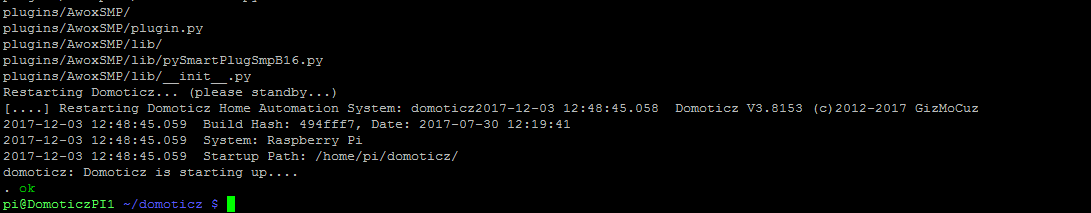

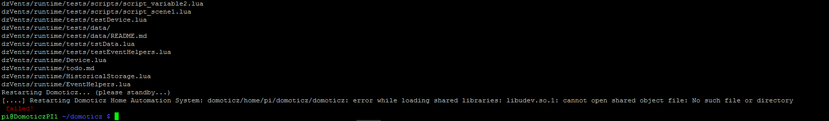

I did an ./updatebeta:
As you can see, it ends with an error and Domoticz doesn't work any more.
So after that I did an ./updaterelease:
As you can see, it ends fine and Domoticz works again, but still without dzVents in the settings. In the Domoticz lua-editor I can make dzVents scripts, but still without logging.
