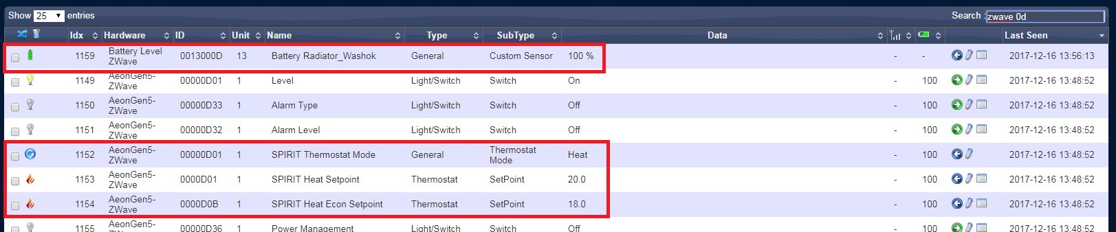

Ropske rececived my spirit thermostat, how many devices do you see?
I expected also a temperature device (temperature in The room) I this right?
Which devices do you have?
Martin
Martin
ropske
- Posts: 483
- Joined: Tuesday 12 August 2014 5:37
- Domoticz version: V3_8394
- Location: Rumbeke,Belgium
Re: new zwave plus thermostat valves
There is a valve temperature meter, i see your id is 0D
Check your complete devices, there be somewhere a temperature device with 0D wit with less 000

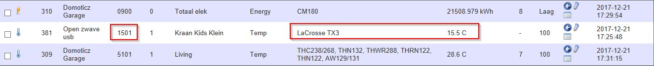

For example, my ID for this valve is 15
as you can see a temp device is added with ID: 1501

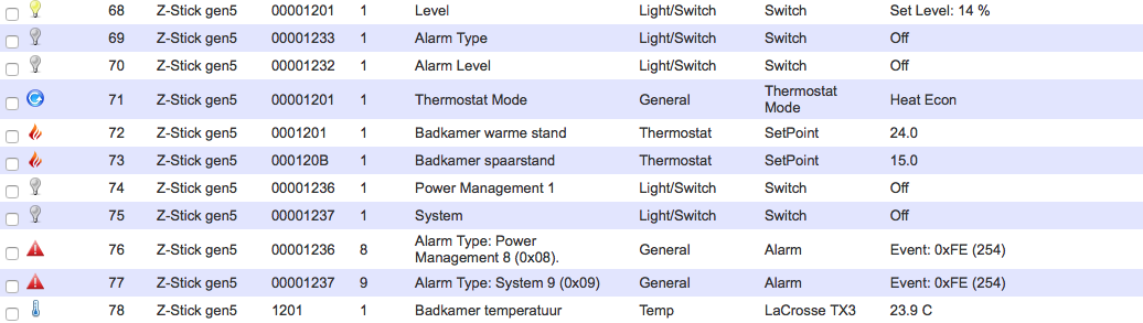

I have installed a Eurotronic spirit. I updated and added the configuration files as instructed by ropske in this thread. Including and installing went without problems.
I have a problem, though. I can set the heating and economy temperatures, and I can read the valve temperature. However, I can't switch between these.
I have a Thermostat Mode device, but this doesn't seem to do anything. I can switch modes in the Hardware settings of my Z-wave USB stick, so the hardware is working.
Any ideas?
Any ideas?
Anyway, have a nice new year's eve and a happy new year!
- Screen Shot 2017-12-31 at 14.51.52.png (107.07 KiB) Viewed 3328 times

sorry for the late response, i dont use the thermostat modes actually, mine is Always on Heat mode.
juste take caution, the thermostat setpoints are from 8°C - 28°C
i also have some popp thermostats and these are from 4°C - 28°C

Thanks, Ropske. This solution works and is acceptable. I hope a future upgrade will make switching between modes possible. I am switching between 18 and 24 degrees, so no problem with the range.
