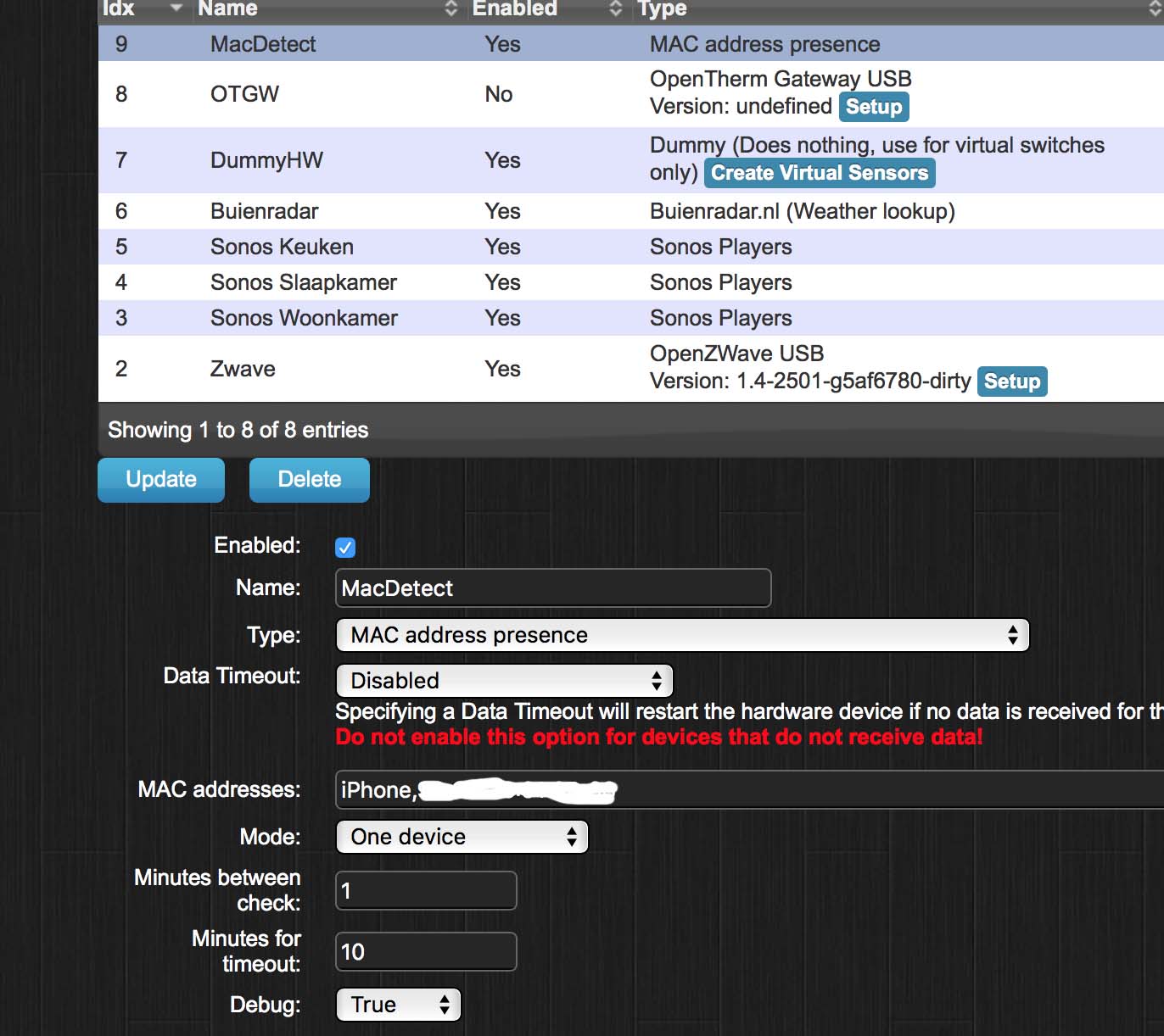

Hi Xorfor,
I'm really interested in this solution, so I installed your plugin and get NO errors
But the device status is not updated either
Running v3.8153 on a RPI
Triple checked the MAC adress, phone is pingable.
Logfile during startup (MACadress is deleted by me, same as the attachment) :

So now both devices work
so my solution is 'S6,12:a3:bc:d4:56:ef'
I'm happy and gonna test some more.
@Xorfor, thx for the help.
I really appreciate it

The new version logfile:
I disabled the WiFi of the S6, just to test.
2017-12-11 22:54:17.969 (DetectMac) Debug log level set to: 'true'.
2017-12-11 22:54:18.170 (DetectMac) Number of mac items: 2
2017-12-11 22:54:18.170 (DetectMac) num: 1
2017-12-11 22:54:18.170 (DetectMac) self.timeouts[num]: 10
2017-12-11 22:54:18.170 (DetectMac) Creating device 'iPhone7'.
2017-12-11 22:54:18.172 (DetectMac) num: 2
2017-12-11 22:54:18.172 (DetectMac) self.timeouts[num]: 10
2017-12-11 22:54:18.172 (DetectMac) Creating device 'S6'.
2017-12-11 22:54:18.173 (DetectMac) 'Author':'Xorfor'
2017-12-11 22:54:18.173 (DetectMac) 'Port':'0'
2017-12-11 22:54:18.173 (DetectMac) 'Version':'1.2.0'
2017-12-11 22:54:18.173 (DetectMac) 'Mode6':'Debug'
2017-12-11 22:54:18.173 (DetectMac) 'Mode4':'10'
2017-12-11 22:54:18.173 (DetectMac) 'Mode1':'iPhone7,xx:xx:xx:xx:xx:xx|S6,xx:xx:xx:xx:xx:xx'
2017-12-11 22:54:18.173 (DetectMac) 'HomeFolder':'/home/pi/domoticz/plugins/MacDetect/'
2017-12-11 22:54:18.173 (DetectMac) 'Name':'DetectMac'
2017-12-11 22:54:18.173 (DetectMac) 'Mode2':'Multiple'
2017-12-11 22:54:18.173 (DetectMac) 'HardwareID':'10'
2017-12-11 22:54:18.173 (DetectMac) 'Key':'macpresence'
2017-12-11 22:54:18.173 (DetectMac) 'Mode3':'1'
2017-12-11 22:54:18.173 (DetectMac) Device count: 2
2017-12-11 22:54:18.173 (DetectMac) Device: 1 - ID: 116, Name: 'DetectMac - iPhone7', nValue: 0, sValue: ''
2017-12-11 22:54:18.173 (DetectMac) Device ID: '116'
2017-12-11 22:54:18.173 (DetectMac) Device Name: 'DetectMac - iPhone7'
2017-12-11 22:54:18.173 (DetectMac) Device nValue: 0
2017-12-11 22:54:18.173 (DetectMac) Device sValue: ''
2017-12-11 22:54:18.173 (DetectMac) Device LastLevel: 0
2017-12-11 22:54:18.173 (DetectMac) Device: 2 - ID: 117, Name: 'DetectMac - S6', nValue: 0, sValue: ''
2017-12-11 22:54:18.173 (DetectMac) Device ID: '117'
2017-12-11 22:54:18.173 (DetectMac) Device Name: 'DetectMac - S6'
2017-12-11 22:54:18.174 (DetectMac) Device nValue: 0
2017-12-11 22:54:18.174 (DetectMac) Device sValue: ''
2017-12-11 22:54:18.174 (DetectMac) Device LastLevel: 0
2017-12-11 22:54:18.224 (DetectMac) Heartbeat interval set to: 60.
2017-12-11 22:54:20.127 (DetectMac) Calling message handler 'onHeartbeat'.
2017-12-11 22:54:20.127 (DetectMac) onHeartbeat called
2017-12-11 22:54:23.528 (DetectMac) num: 1
2017-12-11 22:54:23.528 (DetectMac) Name: iPhone7
2017-12-11 22:54:23.528 (DetectMac) pos: 454
2017-12-11 22:54:23.528 (DetectMac) address: xx:xx:xx:xx:xx:xx found
2017-12-11 22:54:23.528 (DetectMac) num: 2
2017-12-11 22:54:23.528 (DetectMac) Name: S6
2017-12-11 22:54:23.528 (DetectMac) pos: -1
2017-12-11 22:54:25.532 (DetectMac) Calling message handler 'onStop'.

And turned the Wifi ON
2017-12-11 22:58:27.538 (DetectMac) onHeartbeat called
2017-12-11 22:58:30.857 (DetectMac) num: 1
2017-12-11 22:58:30.857 (DetectMac) Name: iPhone7
2017-12-11 22:58:30.858 (DetectMac) pos: 485
2017-12-11 22:58:30.858 (DetectMac) address: xx:xx:xx:xx:xx:xx found
2017-12-11 22:58:30.858 (DetectMac) num: 2
2017-12-11 22:58:30.858 (DetectMac) Name: S6
2017-12-11 22:58:30.858 (DetectMac) pos: 423
2017-12-11 22:58:30.858 (DetectMac - S6) Updating device from 0:'' to have values 1:'On'.
2017-12-11 22:58:30.874 (DetectMac) Update 1:'On' (DetectMac - S6)
Xorfor
Re: Python Plugin: MAC address presence
Thnx for the test!!! I will put this on the todo list, to remove white spaces.
