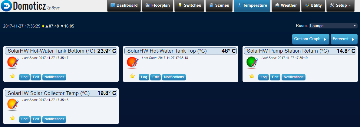

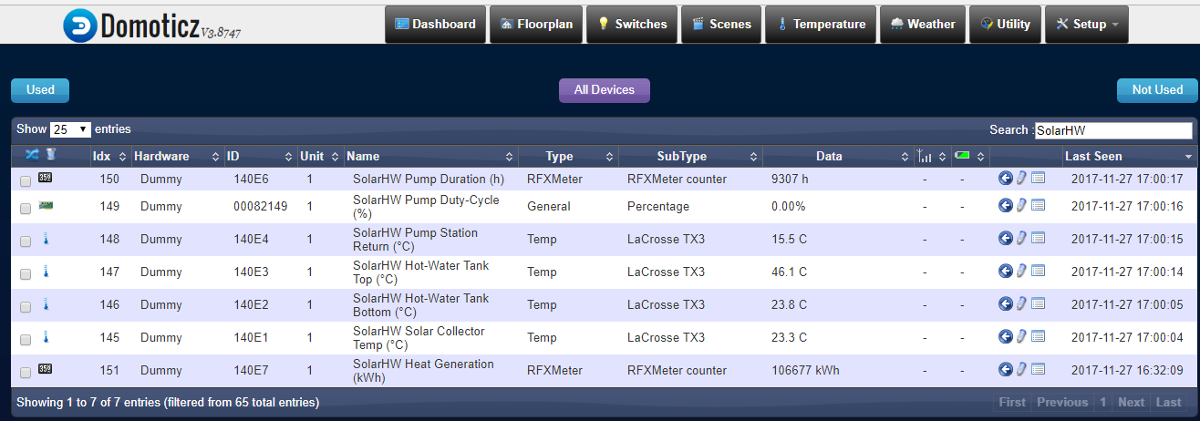

Here's some screenshots of the stats as shown in Domoticz
