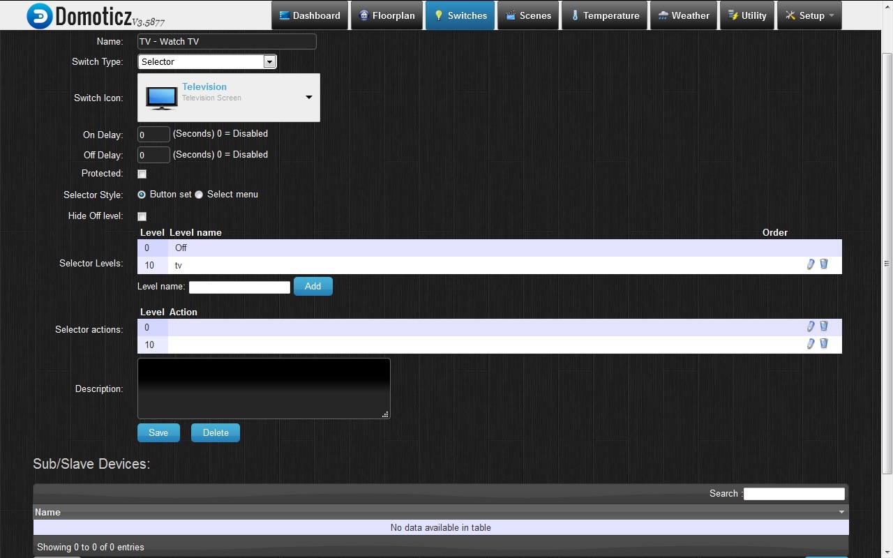

This might help in controlling a Philips TV... Some complicated (I think) logic to control your TV with a selector switch. Only prerequisite is a way of keep track of the energy consumption of your TV. You can use similar construction to switch sound level. You can use http://ip-address:1925/1/doc/API.html to find all possible commands you can send your TV.
1- obtain IP address of your TV
2- use
3- create a selector switch with values 'Off' and the names from the output of step 2
4- create a local variable ('televisie-status') to keep track of the TV
5- now we need to create a scripts to switch the TV
6. The second script is for checking the status of your TV:
7. That's it. Please not that if your TV has been off - not standby but really of power - it has no IP-address. In that case the switch commands will throw an error and nothing will happen. That means you have to use your remote once to turn the TV on. Thereafter the script and switch will work.

Trunald
- Posts: 10
- Joined: Saturday 04 March 2017 11:06
Re: LUA error send command TV
Thank you very much felix63, this is very helpful. Unfortunately I am a completely noob in both Domoticz, and in scripting. I have managed to create the variable, the selector switches, paste the modified script as a saved LUA evenet script, but for the life of me, I cannot figure out how to "call" the script. Not exactly sure whether my selector switches are configured correctly for the purpose, either.
But I am sure I've got the fixed IP of the TV correctly, and Domoticz is communicating with it; I have managed to input text to the TV screen with another script on various events.
I would appreciate your assistance a lot.
- domoticz.jpg (214.9 KiB) Viewed 7731 times
