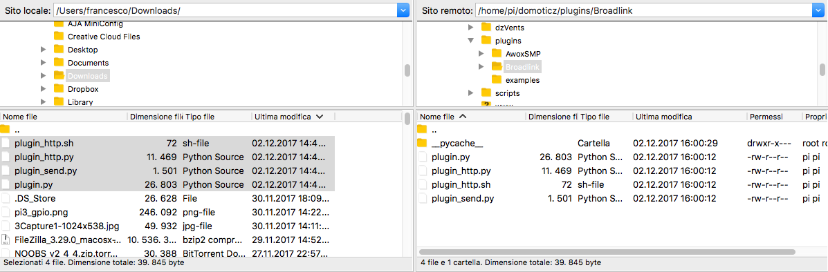

2) then I created the "broadlink" folder in /home/pi/domoticz/plugins /
and added the files I downloaded from the wiki
Schermata 2017-12-02 alle 16.40.21.png (133.02 KiB) Viewed 3752 times

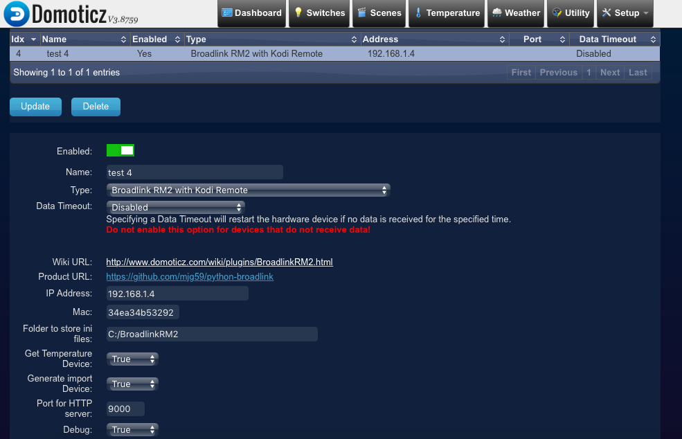

4) added the hardware, but I do not see any devices
Schermata 2017-12-02 alle 16.34.19.png (115.09 KiB) Viewed 3752 times
(I tried with real ip and real mac of broadlink rm pro; and also with ip 127.0.0.1 and mac 000000000000 to search for the device automatically, but I see nothing.
this is the error

Sjonnie2017
Posts: 372
Joined: Wednesday 02 August 2017 19:43
Domoticz version: Latest ß
Re: Python Plugin: Broadlink RM2 V3
Post by Sjonnie2017 »
Hi vchecco,
Try this for the folder to store ini files: /home/pi/domoticz/broadlink_ini
There is no C:/BroadlinkRM2 folder on a Pi ;)
HTH

@vchecco
you need also to copy module broadlink under one of these directories:
'/home/pi/domoticz/plugins/broadlink/:/usr/lib/python35.zip:/usr/lib/python3.5:/usr/lib/python3.5/plat-arm-linux-gnueabihf:/usr/lib/python3.5/lib-dynload'.
I would do it under /usr/lib/python3.5 but it's up to you ;)

zak45 wrote: Sunday 03 December 2017 12:45 @vchecco
hi zac, thank you very much for your help
I do not understand why "Crypto" ("C" uppercase) was put in / user / lib / python3.
so I made the copy from this dir and everything worked properly.
