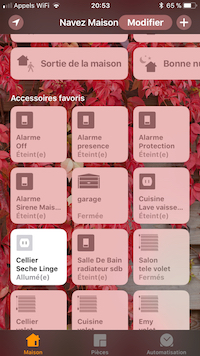

in the device switch on /off you have
action on : http://ip:8080/json.htm?type=command&pa ... X&nvalue=0
action off : http://ip:8080/json.htm?type=command&pa ... X&nvalue=1
You can adjust 0 and 1 to have a good open or closed door
And in homebridge add virtual device door lock
And if you wan't see a real garage door in home app just name "garage" for virtual device door lock
and use modify git edomoticz
https://github.com/fennec622/homebridge-edomoticz
and if you change icon light in domoticz homekit add light in auto not switch
same with fan same with outlet
- Capture d’écran 2017-09-30 à 20.55.53.png (32.12 KiB) Viewed 8309 times
- IMG_E0F0D355846A-1.jpeg (103.7 KiB) Viewed 8311 times
