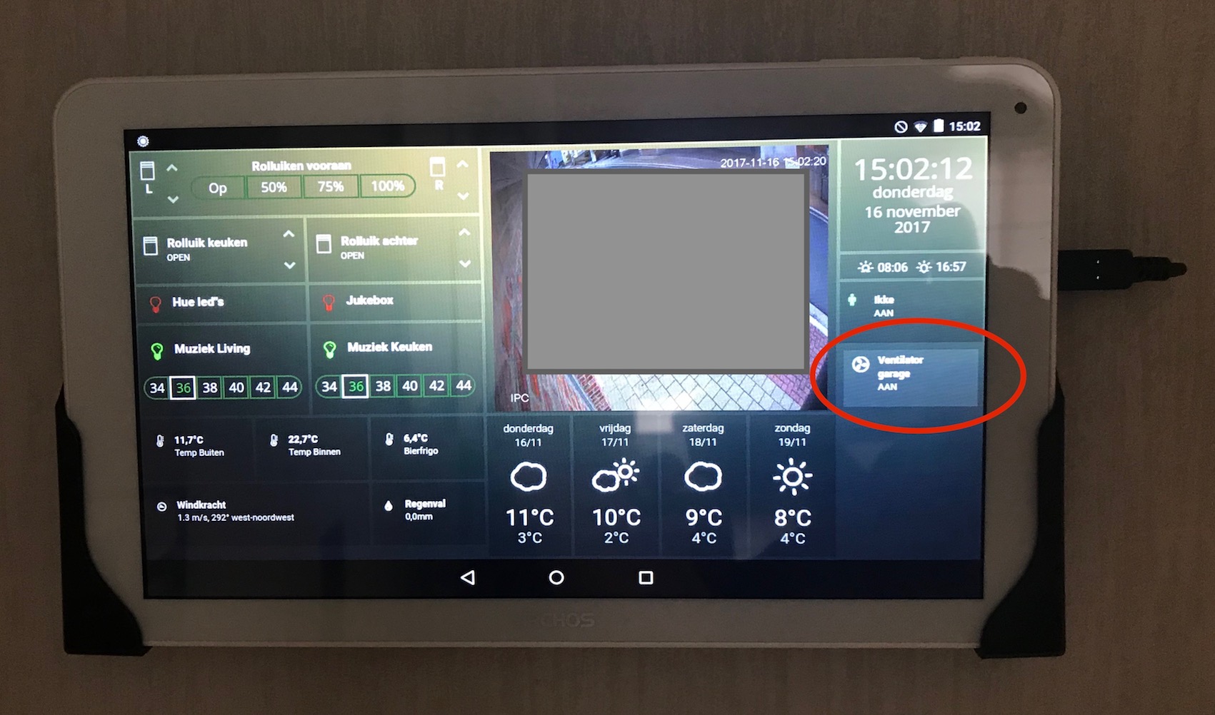

Hi all, i gave a question about the hover effect on the buttons.
like you see on the image below, after activating the button, the hover effect maintain, just until you touch another button or empty space on the screen.
Is it possible to avoid that with some css code?
I'm running the latest Beta.
I would really appreciate any help on this.
