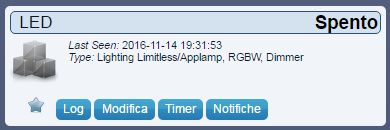

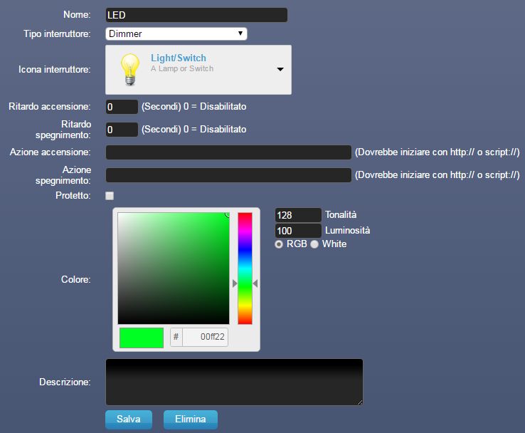

Re: RGB Stripe with Fibaro RGBW controller
in the switch configuration... you should see somthing like this:
- Cattura-1.jpg (14.92 KiB) Viewed 2536 times
- Cattura-2.jpg (44 KiB) Viewed 2536 times
Hello emmo,
ah - thanks for the clarification. Unfortunately I still have the same result on RGB stripe. When I select white the LEDs turn off. No luck with this setting.
Cheers!
Cheers!
