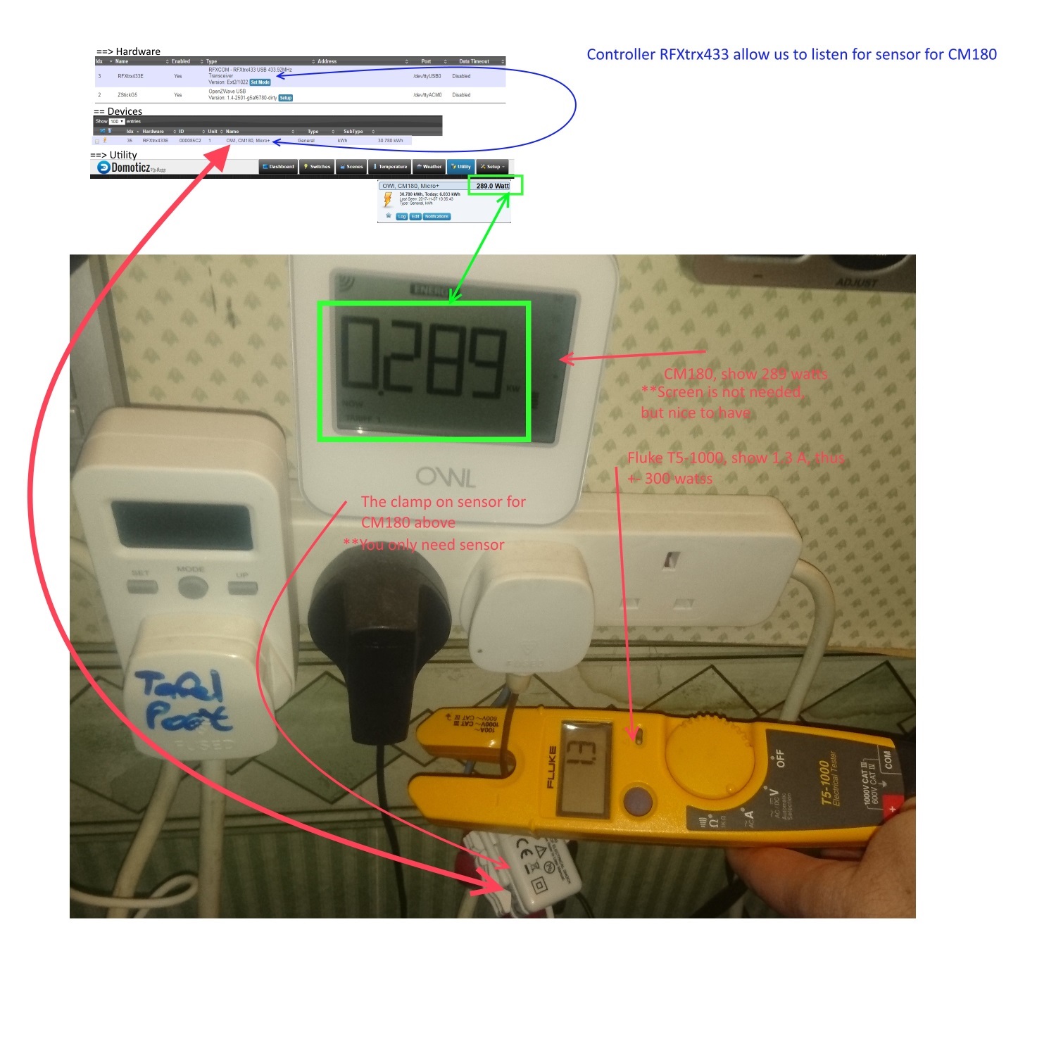

- greenisnews
- Posts: 8
- Joined: Saturday 28 October 2017 21:40
- Domoticz version: 3.8153
- Location: London
Re: Looking for z-wave (plus) smart plug 16A
Buy any domestic "Electricity Monitor" compatible with whatever controller you already have. This free you from the hard task to find a single power plug that will read and record high loads +- 10A, > 2000 watts.
Say you want a z-wave speaking "Electricity Monitor" , perhaps this will work.
In my case I had two existing controllers.
ZStick-Gen5_ZW090-C and RFXtrx433E.
I bought the "Owl micro+ CM180" as it would work using LigtwaveRF on 433Mhz with my existing RFXtrx433E. {I had to check and ensure these are compatible beforehand}
The CM180 speaking LigtwaveRF would cost me +- £33 {you only need the sensor, this will cost even less, say +- £10} vs a a z-wave speaking Electricity sensor" for +- £70.
The pain, we need to ensure that any sensor we buy works with whatever controller we own, or, buy another controller. I see you have a "433MHz Superheterodyne 3310 RF Link". You need to check and see if it will speak to the "Owl micro+ CM180" or find an "Electricity Monitor" that does.
Perhaps this will help others.
