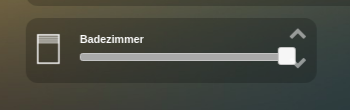

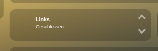

@robgeerts
Hello, my blinds percentage are shown as blinds without positioning. When I change them within Domoticz to blinds percentage inverted I will get a nice slider. But the direction is wrong. Around page 26 there was already a discussion but I couldn't find solution. I use Fibaro roller shutter 2 controler and one philio controler. According to my experience inverted is just needed when the wires connect to the controlers are crossed, so just swap the cables and no need for inverted anylonger. The stop button could be necessary and depends on settings in controler configuration toggle/momentary/single momentary.
Please could you add the slider for blinds percentage?
I like the handling in Domoticz where you just hit the icons to open or close the blinds, instead of arrows up and down. Is that possible to add this to?
Thanks for your great pice of coding

is it possible to add Blinds Percentage to supported devices. As I'm not a coder im not sure but I found in main.js just support sliders for Inverted blinds.
I tried some changes in main.js without succes. So any help is needed.
"AddjMulti" : 1.0,
"AddjMulti2" : 1.0,
"AddjValue" : 0.0,
"AddjValue2" : 0.0,
"BatteryLevel" : 255,
"CustomImage" : 0,
"Data" : "Closed",
"Description" : "",
"Favorite" : 1,
"HardwareID" : 2,
"HardwareName" : "Z-Stick",
"HardwareTypeVal" : 21,
"HaveDimmer" : true,
"HaveGroupCmd" : true,
"HaveTimeout" : false,
"ID" : "00002101",
"Image" : "Light",
"IsSubDevice" : false,
"LastUpdate" : "2017-11-08 17:01:24",
"Level" : 100,
"LevelInt" : 100,
"MaxDimLevel" : 100,
"Name" : "Badezimmer",
"Notifications" : "false",
"PlanID" : "0",
"PlanIDs" : [ 0 ],
"Protected" : false,
"ShowNotifications" : true,
"SignalLevel" : "-",
"Status" : "Closed",
"StrParam1" : "",
"StrParam2" : "",
"SubType" : "Switch",
"SwitchType" : "Blinds Percentage",
"SwitchTypeVal" : 13,
"Timers" : "false",
"Type" : "Light/Switch",
"TypeImg" : "blinds",
"Unit" : 1,
"Used" : 1,
"UsedByCamera" : false,
"XOffset" : "0",
"YOffset" : "0",
"idx" : "194"
else if(device['SwitchType']=='Blinds Percentage Inverted'){
									html+='<div class="col-xs-2 col-icon">';
									   if(device['Status']=='Closed') html+='<img src="img/blinds_closed.png" class="off icon" />';
Thanks in advance

@sailmich, please try latest version!
@ALL, sorry, I'm a little busy lately, its hard for me to keep up all requests.
Its better to add them to the github so I can manage them better: https://github.com/robgeerts/dashticz_v2

@robgeerts
I tried to update via git pull and got.
error: Your local changes to the following files would be overwritten by merge:
	js/main.js
Please, commit your changes or stash them before you can merge.]
I just took main.js but then I got Domoticz offline message. I put my old main.js back and Domoticz was online. Compare your new main.js with old one. Old 74,6 kB new 68,8 kB? I assume when something added the file must be bigger, so maybe something went wrong.

@htilburgs, do you have json-output of a blinds-device for me?
@sailmich, I removed some code for debugging purposes, so thats why it is smaller...
Test latest BETA by pulling it in a new folder.

@robgeerts
No changes still no slider for Blinds percentage.
