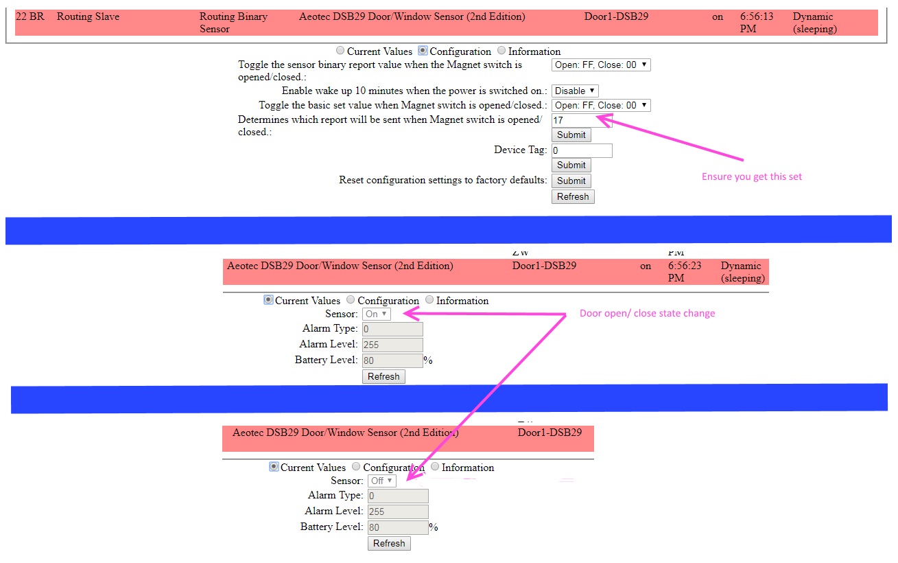

Some feedback I hope will help others.
You can buy and use this door sensor with Z-wave:
FOXX A75WA, Aeotec DSB29 Door/window @ £15 in maplin
{Busy testing it on a fan so it moves back and forth so state change every ten seconds. +- 1000 changes and still working fine.}
You must do the following to get this to work.
In Domoticz v3.8153 after you paired the door sensor DSB29 do:
Go to Setup, Hardware, "Click setup on your Zwave controller", Click "node management", "Control panel"
Now select the sensor, for me it is listed as "Aeotec DSB29 Door/Window Sensor (2nd Edition)"
Ensure you do:
Under configuration set "Determines which report will be sent when magnet switch is opened/ closed." = "17".
Credit: "272" also worked as per this post
Now you can see under "Current Values",
When you remove the sensor from wall, "Alarm Level:" will change "0 / 255". This was working anyway, still works.
When the magnetic sensor is triggered (door open/close) "Sensor" will change "on/ off". You made this work, yay!
See image below:
Enable door sensor to work.jpg (190.78 KiB) Viewed 3226 times

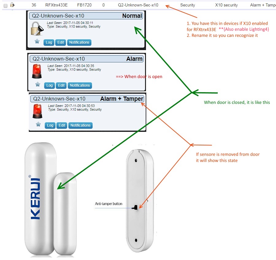

This may help others.
How to get Kerui, D026, 433Mhz working.
3 states, Closed, Open, removed/ tamper.
Kerui, D026, 433Mhz {use 23A 12V battery}
Platform, Windows and Linux.
Sofware: Domoticz v3.8153 firmware, RFXtrx433_Ext2_1022.
Controller: I use RFXtrx433E~LightWaveRF.
In Domoticz v3.8153, go to Hardware, for "RFXtrx433E" click "set mode". {Ensure you have the correct firmware!}
Enable protocol "X10".{Correction, you also need "Lighting4"} {Only enable protocols you need, some break others. Thus any issues only enable X10 and "Lighting4"}
Now go find sensor in "setup", "devices", rename and add it.
Kerui, D026, 433Mhz, GreenIsNews, aka fun6, manual.jpg (141.88 KiB) Viewed 3176 times
Last edited by greenisnews on Sunday 05 November 2017 8:11, edited 1 time in total.
