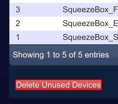

New in ihe latest bèta (9014):
Option to delete unused device from the nodelist in the hardware-setup of LMS.
simon_rb
Posts: 612
Joined: Wednesday 07 August 2013 19:09
Location: UK
Re: Remove Logitech Media Server player?
Post by simon_rb »
Thats awesome, thanks.
Not sure whether to chance the latest beta! I might wait until the final version.
Great progress though and thank you!
