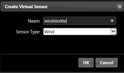

@elmortero,
I use dzevnts to split the separate values, but I first need to create the virtual sensors for every separate value
But when I create a sensor with the type wind, I get a sensor that expects 5 values. And I want to have a wind sensor with one value
create virtual sensor.JPG (20.04 KiB) Viewed 1507 times
created device.JPG (19.17 KiB) Viewed 1507 times

You should use custom sensors

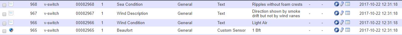

Post by elmortero »
This might be something for you. I don't know about Dashticz as I do not use it.
I made following (dzVents) script and created 4 virtual sensors:
  • Beaufort - a custom sensor with Bft as axis Label
  • Wind Condition - a text sensor with the Beaufort description
  • Wind Description - a text sensor that shows the Beaufort conditions
  • Sea Condition - a text sensor that shows the sea conditions
