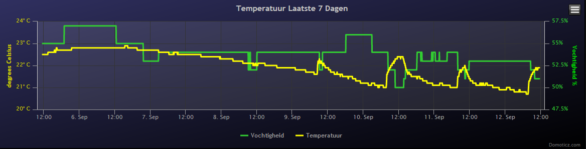

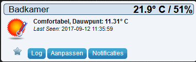

Post by cobra045 »
For RFXcom 433E receiver use this
https://www.banggood.com/DANIU-433MHz-W ... 65559.html
With the results below
