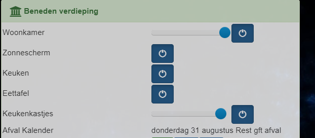

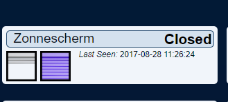

Hi Safi78, i have a sunscreen which is controller by a fibaro roller shutter but all i see is a on/off switch.
This is the json for this deice:

Can you fix this?

tlpeter wrote: Monday 28 August 2017 18:37 I have a sunscreen which is controller by a fibaro roller shutter but all i see is a on/off switch.
That is how it is implemented at this moment. It shows a Blue button for when it is (partially) closed and a green button for when it is Open.
It sends a Toggle Switch when pressed.
Jos
