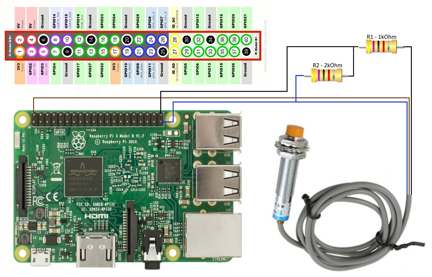

so by putting 5v on a pin that is meant to receive 3.3v you potentially break your pi.

Is there also any good solution for this? I followed the link, but when it starts to give me diagrams I get a bit confused as I'm not into those at all...
Hobbybob
Re: Watermeter lezen met raspberry en Inductieve NPN sensor
Post by Hobbybob »
Okay, I've tried to read up on the information about this, and I came up with the following wiring-scheme. As said, I am not very good at reading diagrams with symbols, so I made something a litte more visual for myself.
Can anybody with a little more knowledge than me check if this would be a good way? I calculated the 1kOhm and 2kOhm on the site oohlaf mentioned, and fiddled with the Ohms to get two values that I can actually buy, and produces as close to 3.3V as possible.
Schakeling watermeter.jpg (299.74 KiB) Viewed 5178 times
oohlaf
Posts: 21
Joined: Monday 06 February 2017 0:57
Post by oohlaf »
Yes, you got it right, you can also have a look at this topic:
viewtopic.php?f=17&t=1103&start=40
