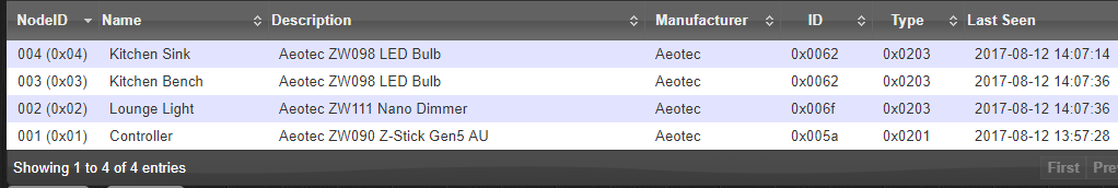

I included two new Aeotec Z-Wave bulbs to my network.
The second bulb has been given the same ID as the first bulb. Is that a bug?
It doesn't appear in the devices list either, so I can't use it. I've tried removing it and re-adding it, but it gets given the same ID each time.
Any ideas?

It is about the nodeID, the manufactor is the same as it is the same type of device so this is normal.
I have the same ID for multiple devices of the same type.

Ah, that's good to know. In that case, the problem is that I just can't see the second globe in Domoticz. I can see it in OpenHAB, so I know it works. (I just tried OpenHAB to see if it works - I'm not running any other system in parallel or anything like that).

Try excluding it and include it again.
Open a second webinterface and look in the log while including it.

Nothing stands out in the log...
2017-08-12 16:28:20.207 New sensors allowed for 5 minutes...
2017-08-12 16:28:20.207 OpenZWave: Node Include command initiated...
2017-08-12 16:28:38.842 OpenZWave: Node Removed. HomeID: 3235667781, NodeID: 7 (0x07)
2017-08-12 16:28:38.868 OpenZWave: New Node added. HomeID: 3235667781, NodeID: 7 (0x07)
2017-08-12 16:28:38.868 OpenZWave: Value_Added: Node: 7 (0x07), CommandClass: SWITCH MULTILEVEL, Label: Level, Instance: 1
2017-08-12 16:28:38.868 OpenZWave: Value_Added: Node: 7 (0x07), CommandClass: SWITCH MULTILEVEL, Label: Bright, Instance: 1
2017-08-12 16:28:38.868 OpenZWave: Value_Added: Node: 7 (0x07), CommandClass: SWITCH MULTILEVEL, Label: Dim, Instance: 1
2017-08-12 16:28:39.098 OpenZWave: Value_Added: Node: 7 (0x07), CommandClass: COLOR, Label: Color, Instance: 1
2017-08-12 16:28:39.098 OpenZWave: Value_Added: Node: 7 (0x07), CommandClass: COLOR, Label: Color Index, Instance: 1
2017-08-12 16:28:40.903 (Hub1) Light/Switch (Level)

I seemed to have built up a collection of unused RGBW devices. Deleted them. I can use the new light now.
