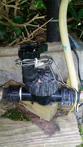

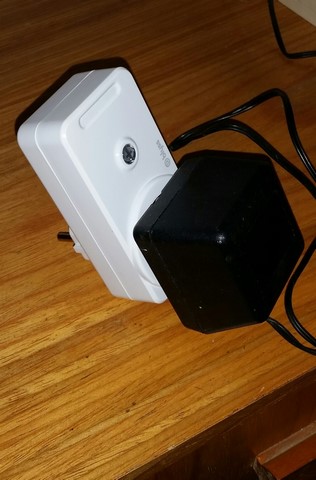

I use a couple of Rain Bird 100HVMM valves. They work under 24volts AC, so you also need a transformer/adapter. And any RFXCOM (or ZWAVE) wall plug to turn power on and off.
