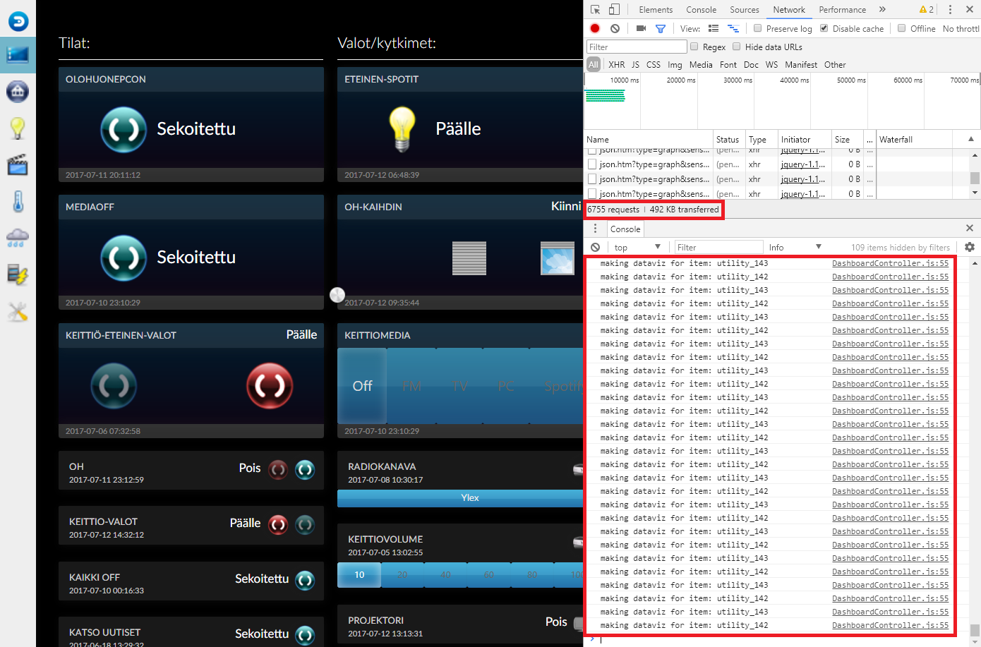

I just had a strange problem with endless queries:
I left it open for a hour(or two). Then went back to dashboard and this happened.
edit:
Could this cause the problem?
addDataviz = function () {
setInterval(addDataviz, 600000); // updates the dataviz every 10 minutes.
Should the clearInterval be used when entering before adding it again?
edit:
I think its about that:
LXC(x64 Ubuntu Xenial), RFXtrx433E, MySensors

@pj-r: thanks for the help! Could you perhaps create the JS code that would fix this problem? If you have a github account you can even add in the changes here: https://github.com/domoticz/domoticz/bl ... troller.js

Thanks, I've added the fix to Github.
