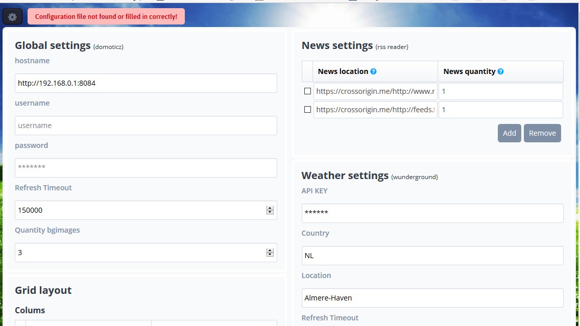

I can not do anything because nothing writes
Framb works on my server without problems
Why does your project not work?
- framb.jpg (122.97 KiB) Viewed 5538 times

Dear vgr2, Domoticz default installation comes with a webserver but it doest understand PHP, the easiest way for you is probably install the following program ( http://www.usbwebserver.net/nl/ ) on your desktop run de folder that you downloaded from the link provided in de instruction then opening the localhost:8887 and fill in your settings than copy all files including the correctly filled in config.json to your webserver with winSCP and you should see everything up and running if settings are correct!
Re: [ DomoDash ] a Angular tablet/mobile dashboard
Dear kniazio, Framb doesn't require PHP because it saves the minimal settings that is has in the localstorage but that dont work on every device because localstorage is not available on every device. So i would tell you again if you dont have PHP installed you cannot save your settings, the probably easiest way for you 2 is follow the same instructions I gave vgr2 or Install PHP on your webserver.
Man.
I have Apache2 + MySql PHP
I have loads of other PHP and MYSQL based projects and they work
I have a running Owncloud which is demanding when it comes to PHP and MySql.
Framb also requires PHP
Dear kniazio, I have made a UPDATE so now you can download your (settings) config.json manualy and then just upload it to root and it should work fine!
If you really want the auto save with php to work I must troubleshoot it correctly and because it works on my system and a Colleague I cant replicate the problem. The only way I could solve it is if you can give me access with teamviever or make a screenshot of your browser console/network tab output.

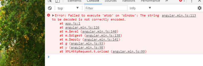

I see only your nice picturedycati wrote:Dear vgr2, Domoticz default installation comes with a webserver but it doest understand PHP, the easiest way for you is probably install the following program ( http://www.usbwebserver.net/nl/ ) on your desktop run de folder that you downloaded from the link provided in de instruction then opening the localhost:8887 and fill in your settings than copy all files including the correctly filled in config.json to your webserver with winSCP and you should see everything up and running if settings are correct!
This happens because your did'nt fill in your username and password of Domoticz, probably because you did'nt use a username and password
for your domoticz and this application needs it. This got nothing to do linux it just runs fine on my HP microserver with XPenology so give me a break.
Also User and password was filled in .....
