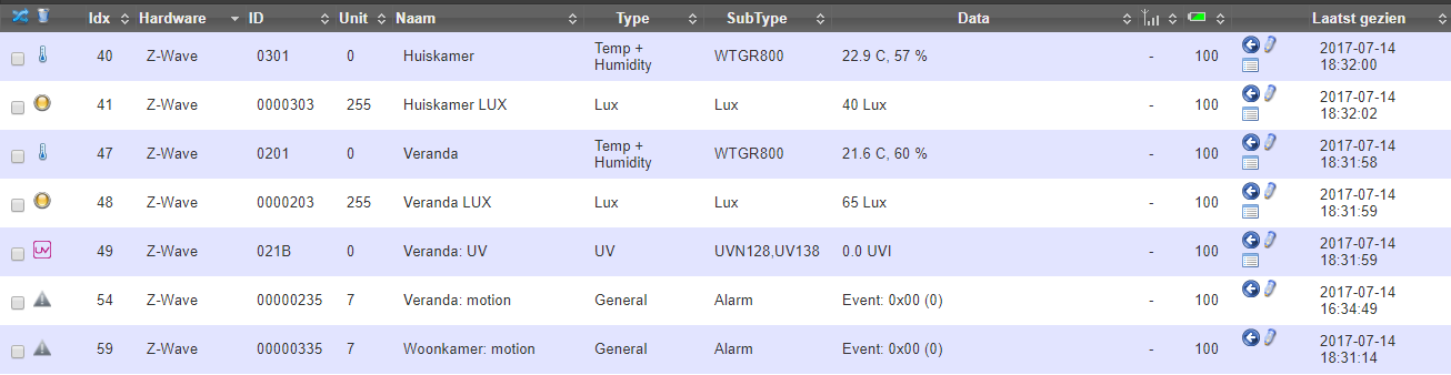

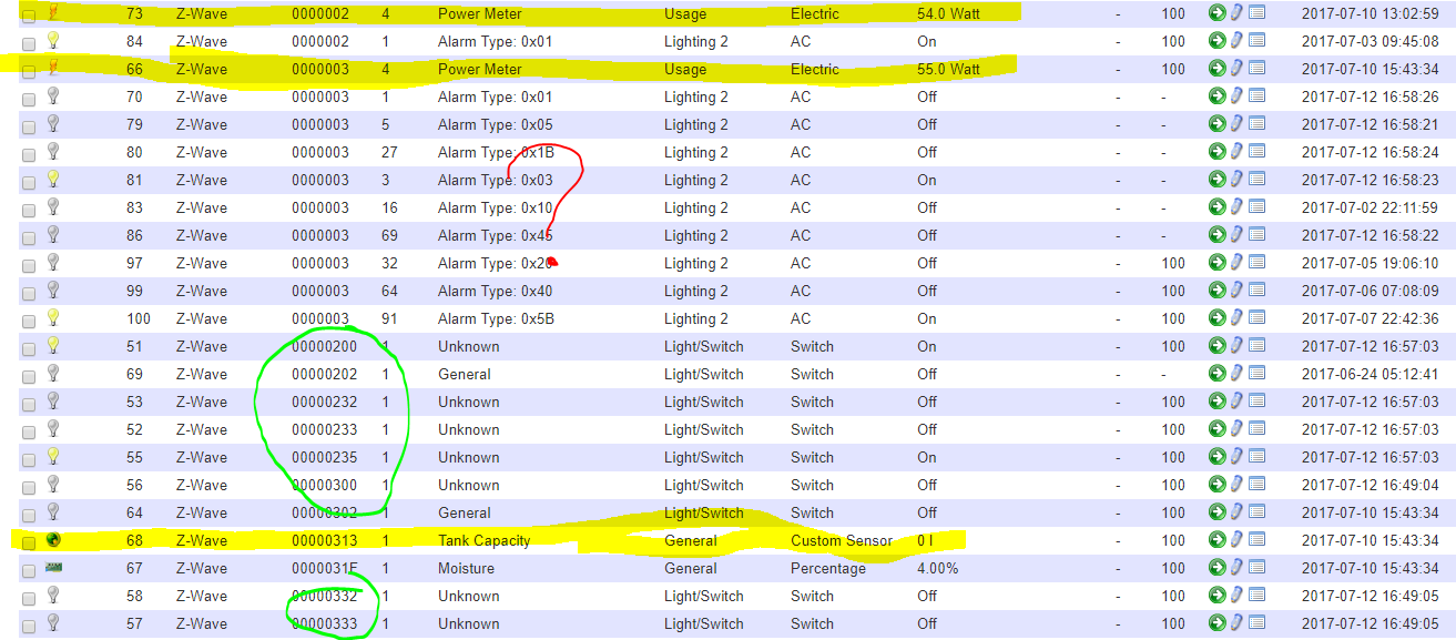

Re: Z-Wave and security
I dont know. When I added the sensor I got a bunch of devices. I named them and added them to my 'in use devices' The first motionsensor had an Id range in 2xx and the second multisensor had a bunch of devices in the ID range of 3xx. Like UV, Lumen, Humidity, Temperature, Binair alarm for vibration and motion sensing. So the unknow devices list was empty. A few day later there were some unknown devices added. And now there are a lot of them (see atachment) There are power meters , tank capacity meters, switches, etc detected and I do not own a power meter, atleast not that I know of. Let alone that i paired them.

Re: Z-WLooks like you have paired multiple times and left rubbish behind.ave and security
It looks like this device is not fully or unsuccessful included. Since there are 2 identical sensors, one has moisture and the other doesn't
The alarm types are part of this senor, like burglar, motion, alarm type, sensor, lux..... in your screenshot those are 0000002 and 0000003
I expect that the power Meter is the reading of the UV sensor in W .
The tank........
Please have a look at Domoticz config folder: /home/pi/domoticz/Config/aeotec/zw100.xml, here you can find more info.
I thing though, regarding the original question, these are all yours.
No thats not true. These are the devices listed as Unused.The moisture sensor you see is, what I think, not mine. My 2 devices have moisture and those are in the other list. (See screenshot) The previous screenshot is the list I could not make sense of.
I have six Aeotec ZW100 MultiSensor 6.
Beside their "normal" devices they introduce different types of other devices. Each one has its own variety. Clocks, alarms, usage, electric, heat, you name it. In the beginning I also found some "impossible" devices. After deleting the sensor and re-adding they did not appear again. The Alarm, usage etc. are "normal".
If the beginning of the ID's is the same, the devices belong to that sensor. 100% sure. You will see that only the last two digits vary and so do the unit numbers. The ID's have different numbers of zeroes at the start.
I suppose you have been struggling with adding the sensors and there are remains of the various attempts. I also once had power meters and tank capacities. I deleted them and they did not come back again.
Suggestion: Delete the sensor; delete ALL devices belonging to that ID; restart Domoticz; Add the sensor again.
