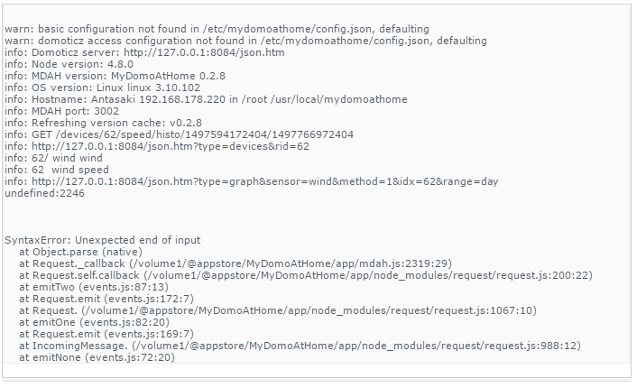

I am just starting to use it on my Synology DS412+ server. I used to run Domoticz on a Windowsbased computer, but moved everything to Synology.
I saw the option to use Imperihome and loving it. I installed the latest version of MDAH and everything runs well. But I have noticed that the MDAH service stops at least once a day. After re-starting it through the package center it's okay again.
This is what I can find in the logs:
Thanks for any idea how to solve this. Right now I have Task run the service every hour, but it sometimes makes me wait for 59 min before starting again.

npm ERR! A complete log of this run can be found in:
npm ERR!     /root/.npm/_logs/2017-07-10T22_14_54_665Z-debug.log
dpkg: error processing archive /var/cache/apt/archives/MyDomoAtHome_0.2.8_all.deb (--unpack):
 subprocess new pre-installation script returned error exit status 1
Errors were encountered while processing:
E: Sub-process /usr/bin/dpkg returned an error code (1)
pi@raspberrypi ~ $
pi@raspberrypi ~ $ node -v
v8.1.3
pi@raspberrypi ~ $ npm -v
5.0.3
pi@raspberrypi ~ $
Doler
Posts: 163
Joined: Friday 31 July 2015 21:02
Location: Sint-Oedenrode, Netherlands
Re: [MyDomoAtHome] Support thread
Post by Doler »
Your node version is too high (incompatible), uninstall and use
curl -sL https://deb.nodesource.com/setup_7.x | sudo -E bash -
sudo apt install nodejs
Resulting node version should be v7.x.x, npm version should be v4.2.x.
