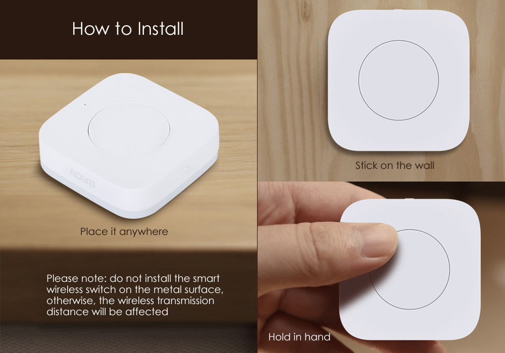

Does anyone have this switch? And is it working?

not working yet, only old round version. But they working on it!

mmm is this a third party?
Like my tempsensors...
Think they are not supported

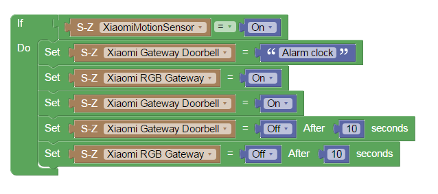

First: Great work, everything up and running in minutes thanks to the programmer(s) and the wiki!
I would like to play a sound with the gateway, somehow the following blocky does not work... can anybody help me?

You will have to use it as selector switch which is represented as a percentage. So 10% for the first one, 20% second one, etc

jjnj wrote:You will have to use it as selector switch which is represented as a percentage. So 10% for the first one, 20% second one, etc
Thnx, added this info to the wiki page
