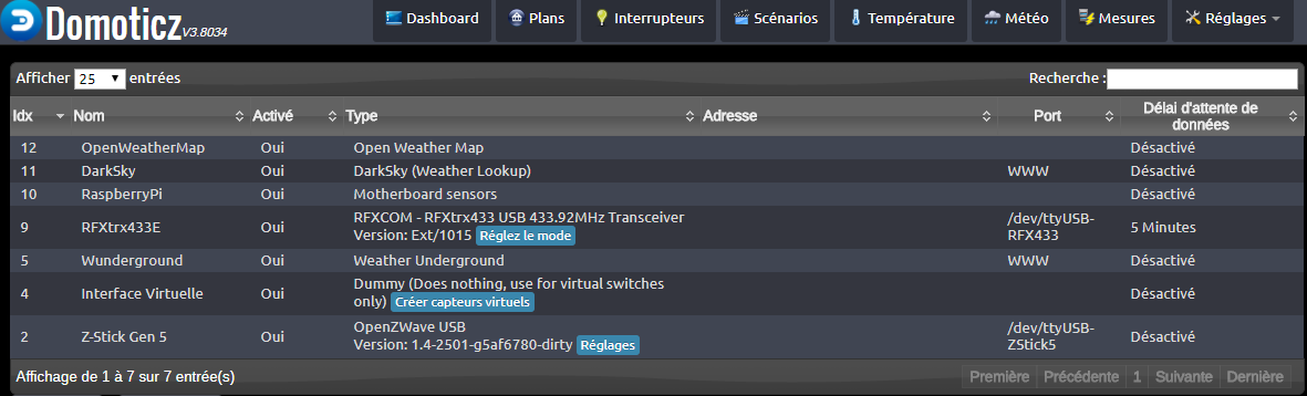

regarding my hardware : see the picture.
-> I will try to remove the motherboard sensor hardware. but do you know where I can find some scripts examples to replace it ?
EDIT : I observed domoticz using up to 20% of cpu when motherboard sensor disabled instead of 30% with it.

jeanclic, is it possible for you to see which hardware may cause this for you? Can you make a copy of your entire setup (or just the database) and perhaps remove some hardware of scripts to see when the cpu load drops to normal levels?
It's so hard to debug this if you cannot reproduce it yourself.
Your help is greatly appreciated in this. We have to nail this bugger!

beeing completely newbie regarding dzVents, I wonder if this path is correct ?
2017-07-02 15_57_58-Debian - Oracle VM VirtualBox.png (11.25 KiB) Viewed 2515 times
