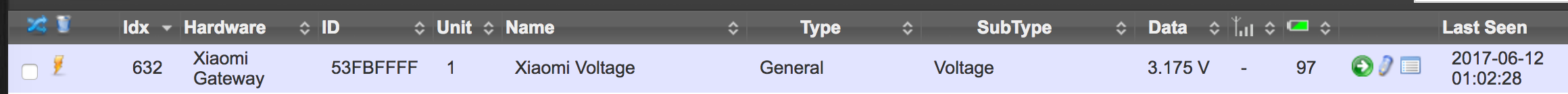

Just installed Domoticz build 3.7712 which includes the commit for the smoke detector.
In devices I have a new device added:
Screen Shot 2017-06-12 at 1.09.48 am.png (71.3 KiB) Viewed 3021 times
There is no device for controlling the smoke detector though or seeing if it is active...?

I have test it with a bbq, when smoke is here he ring and gateway flash on red and ring too.
On domoticz he turn on.
Don't forget to allow new device and press button one time, he will arrive on unused device.
Bad point of this device is our none ability to make it ring from aqara api...this will be usefull for.a weekly test.

It showed up over night while I was asleep, just added it. Thanks
