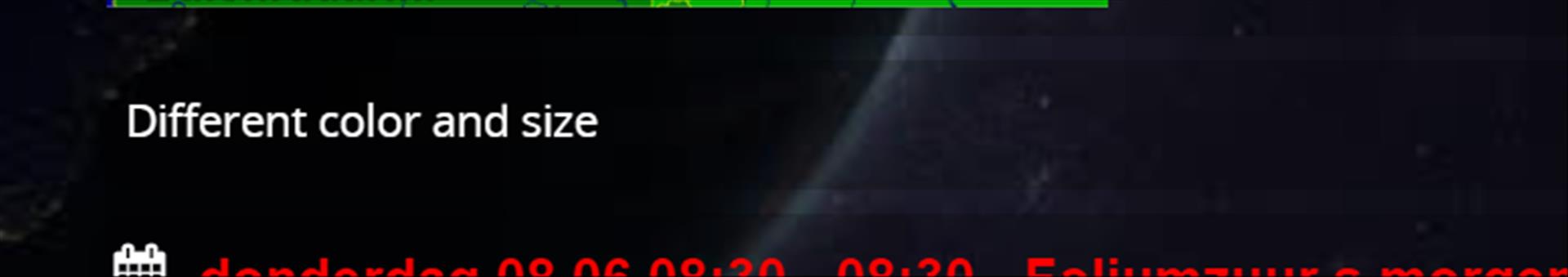

Some questions:
Can i adjust the size and color of the title, i use:
And that give:
Try to change that.....
Is there perhaps a option to change colors for this day events and the actual event.
Like actual green
the day blue
etc
And is it possible to load directly ical into the script?
So i can use the combined calendar out of the box with ical
Now i need to make for the formule a new calendar.
Kids holidays
Kids footbal etc
to get different colors

Some questions:
= {width:12, maxitems: 10, icon:'fa-calendar', title: 'Different color and size', icalurl: 'https://calendar.goIs there perhaps a option to change colors for this day events and the actual event.
Like actual green
the day blue
etc
Kids holidays
Kids footbal etc
