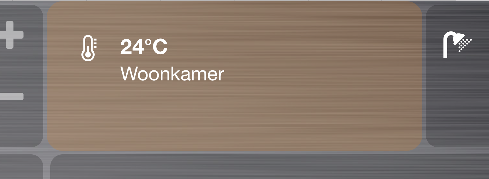

I'm using:
.transbg.col-xs-1, .transbg.col-xs-2, .transbg.col-xs-3, .transbg.col-xs-4, .transbg.col-xs-5, .transbg.col-xs-6, .transbg.col-xs-7, .transbg.col-xs-8, .transbg.col-xs-9, .transbg.col-xs-10, .transbg.col-xs-11, .transbg.col-xs-12 {
    padding-top: 15px;
    padding-bottom: 15px;
    border: 2px solid rgba(255,255,255,0);
  background: rgba(0,0,0,0.2);
  background-clip: padding-box;
border-radius: 9px;
for the size and rounded corners of the buttons. How can I use (for instance) the orange style code to get the same sized button? Tried a few things, but it still has another size. See attachment.
Schermafbeelding 2017-05-23 om 19.18.20.png (266.8 KiB) Viewed 4588 times

mvveelen
Posts: 721
Re: Dashticz - [BETA] - Function - Do something at a specific value
Post by mvveelen »
htilburgs wrote:If you use this code, I think it should be the same....
.warning {
   background: rgba(204,129,44,0.30) !important;
   border: 7px solid rgba(255,255,255,0);
Unfortunately it isn't:
Schermafbeelding 2017-05-25 om 12.07.02.png (290.53 KiB) Viewed 4520 times

mvveelen
Posts: 721
Post by mvveelen »
I get the same result when I delete that line.

robgeerts wrote:I did this to have different colors, depending on the temperature of my living room:
function getStatus_145(idx,value,device){
	if(parseFloat(device['Data'])>23){
		$('div.block_145').removeClass('warning').addClass('warningorange');
	else if(parseFloat(device['Data'])>25){
		$('div.block_145').removeClass('warningorange').addClass('warning');
	else {
		$('div.block_145').removeClass('warning').removeClass('warningorange');
Hi Rob,
I think you need to switch the higher value with the lower value.
Your code did not work for me, the blocks remained orange even though the value exceeded 25.
My code:
//kleurtje op knop temp huiskamer wanneer het warmer is dan bepaalde temperatuur (oranje of rood)
function getStatus_90(idx,value,device){
   if(parseFloat(device['Temp'])>25){
      $('div.block_90').removeClass('warningoranje').addClass('warning');
   else if(parseFloat(device['Temp'])>23){
      $('div.block_90').removeClass('warning').addClass('warningoranje');
   else {
      $('div.block_90').removeClass('warning').removeClass('warningoranje');
mvveelen

htilburgs wrote:Ok, quite a puzzle (but a nice one...;-)).
Put this in your custom.css for the .warning part and it should work:
.warning {
	padding-top: 15px !important;
	padding-bottom: 15px !important;
	border-radius: 9px !important;
	background-color: rgba(199, 44, 43, 0.3) !important;
	border: 2px solid rgba(255,255,255,0) !important;
	background-image: initial !important;
	background-position-x: initial !important;
	background-position-y: initial !important;
	background-size: initial !important;
	background-repeat-x: initial !important;
	background-repeat-y: initial !important;
	background-attachment: initial !important;
	background-origin: initial !important;
	background-clip: padding-box !important;
Let me know, if its OK now.
And I see one minor error in your custom.css.
In the #newsTicker li part the */ Set the maxim height of the news-ticker */ shoud be /* Set the maxim height of the news-ticker */
For now it's not causing an issue, but you never now what it causes in the future....;-)
Yesssss, that's it !! Thanks !
Also changed the newsTicker-part :)
