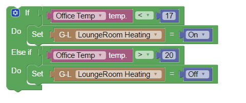

hi guys
i have the following blocky, but it never seems to activate....
current temp as i write this is 19
nothing in logs about fails...it just seems to never evaluate
current values from blocky check current values shows as below
35 Office Temp 19 2017-05-23 16:31:45 19
heating scenario

Re: heating scenario
If it's now 19° it can't do anything. It's not lower than 17 and not higher than 20, right?
ropske
- Posts: 483
- Joined: Tuesday 12 August 2014 5:37
- Domoticz version: V3_8394
- Location: Rumbeke,Belgium
that's also what i see Egrerius
markjgabb
- Posts: 142
- Joined: Tuesday 24 January 2017 23:00
- Domoticz version: 3.8153
- Location: Australia
ah crap....yeah your right...i was reading it bacwards....i now feel really stupid thanks guys wow

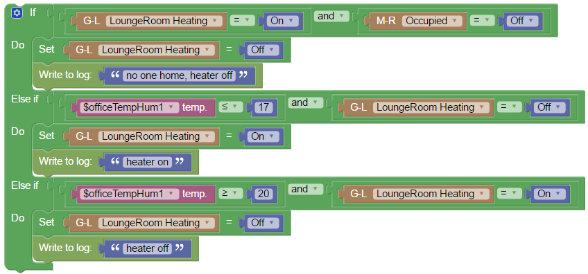

ok heating scenario part 2....
anyone have any ideas how i would go about adding a scenario or perhaps another else if, so that if i turn my heating on remotely it will work..
as you can see ive got presence running with occupied so that when no one is home the heater turns off...
but i would like something so that if im half an hour from home and i know its cold i can turn it on before i get home
One way would be to add a virtual "Manual Override" or an "Auto" Switch
In your scenario you could add an "Override" switch that can work with the Occupied switch:-
If [Heating =On] And [Occupied = Off] And [Override = Off] Do Set [Heating = Off]
Then add the appropriate conditions to the first "Else If":-
Else If [Temp <= 17] And [Heating = Off] And [[Occupied = On] Or [Override = On]] Do Set [Heating = On]
(Note how the "Or" is "nested")
Below is a Blockley I use to successfully control a ceiling fan. Note where the "Auto" condition is required to be on to run the fan or turn it off. So I can switch this to regain manual control.
