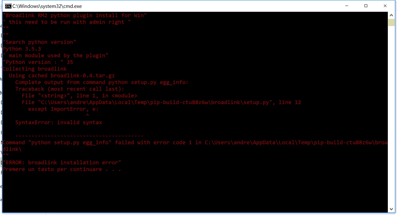

Hi to all..
Windows 10 x64,Python 3.5.3 and problem with setup.exe!
someone help me please!
zak45
Posts: 954
Domoticz version: V2024.4
Re: Python Plugin: Broadlink RM2
Post by zak45 »
ilpier wrote:Hi to all..
the version on pypi (0.4) is buggy , not able to be installed automatically with python v 3.x.
You need to take one from dropbox (0.3) and install it manually.

    Complete output from command python setup.py egg_info:
  File "<string>", line 17, in <module>
  File "/tmp/pip-build-06i1bqfv/broadlink/setup.py", line 12
    except ImportError, e:
SyntaxError: invalid syntax
Cleaning up...
Command python setup.py egg_info failed with error code 1 in /tmp/pip-build-06i1bqfv/broadlink
Storing debug log for failure in /root/.pip/pip.log
the version on pypi have a problem with python 3. download the version 0.3 on the dropbox : python-broadlink-master.zip
and install it :
just decompress on some folder, go to the folder and enter : pip3 install .

zak45 wrote:
letmein wrote:Hello everybody,
i'm tryind few hours now to install RM2 to rpi without success, i've already installed it on another rpi some time ago without a lot hassle, but this time it wont get installed i tried few things that i found here but nothing. The error i get when i try "sudo pip3 install broadlink" is this:
Downloading/unpacking broadlink
  Downloading broadlink-0.4.tar.gz
  Running setup.py (path:/tmp/pip-build-06i1bqfv/broadlink/setup.py) egg_info for package broadlink
Cleaning up...
and install it :
do not forget the dot at the end
Thank you zak, after some cleanup it worked great!
