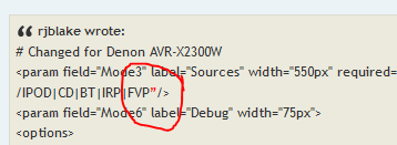

Hello rjblake,
i found the problem for me in your code....marked in red
rjblake wrote: # Changed for Denon AVR-X2300W
<param field="Mode3" label="Sources" width="550px" required="true" default="Off|SAT/CBL|DVD|BD|GAME|AUX1|MPLAY|TV|AUX2|TUNER|USB/IPOD|CD|BT|IRP|FVP/>
<param field="Mode6" label="Debug" width="75px">
<options>
<option label="True" value="Debug"/>
<option label="False" value="Normal" default="true" />
</options>
</param>
</params>
</plugin>
THX, Andyyyy

Andyyyy - glad you found it - was going to suggest using the standard script as opposed to mine. Can't see any red text, so not sure what was different?

it is the last quote mark in the Sources section.

Ah - damn the different types of "''s ...and being colourblind! I've corrected in my earlier post in case anyone else just does a copy/paste.
