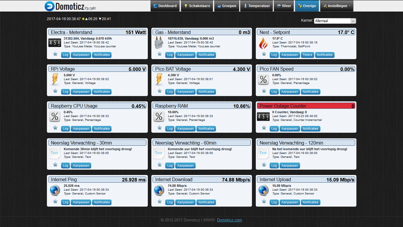

Just wanna say thx for your script.
Using it to monitor some issues with my connection -> isp regarding ping times.
Schermafdruk 2017-04-19 00.38.56.png (295.58 KiB) Viewed 6095 times

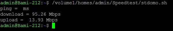

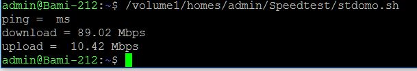

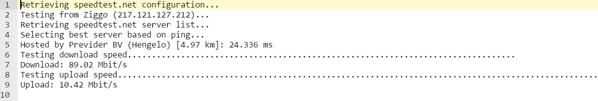

ok, this is what I do.
I connect to the CLI run the following command: /volume1/homes/admin/Speedtest/stdomo.sh (without a password)
I get the following result:
It takes long though for the script to finish, even though the results are already in the script.
+ even though there is no ping time, it does show a ping value in the output.txt file, I guess this is due to the fixed server I selected (5302)
I tried using the script you send in the previous reply, but so far no luck.
Grtz.

Can you try again without the '-s' after the 'curl' command?
As far as i can tell, you don't get a ping value (could be another version of speedtest-cli than I use).
And, curl returns it's result after trying to update domoticz, I don't see that here. (could be another version of curl).
Run it again, without the -s and send the results?

did it.
the result in the output.txt file is as follows:
the output from the cli is as follows:
it cold very well be I got the wrong version.
perhaps you can tell me which one I need for a synology NAS.
do I perhaps need to install a specific version of curl?
Cheers

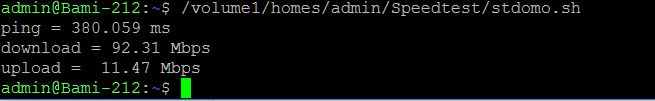

change
/volume1/homes/admin/Speedtest/speedtest-cli --server 5302 > ~/output.txt
to
/volume1/homes/admin/Speedtest/speedtest-cli --simple --server 5302 > ~/output.txt
homebridge, rfxcom, zwave, nest, applamp, hue, debian, apple, mysensors, netatmo, fibaro, synology, foscam, otherz
Trigun
Posts: 390
Domoticz version: 4.10717
Re: How to monitor your internet connection with virtual custom sensors
Post by Trigun »
I got a ping value now :)
see:
but stil no result in Domoticz.
Grtz

#output if you run it manually
echo "ping = $ping ms"
echo "download = $download Mbps"
echo "upload =  $upload Mbps"
curl -s -i -H "Accept: application/json" "http://$username:$password@$host:$port/json.htm?type=command&param=udevice&idx=$pingidx&svalue=$ping"
curl -s -i -H "Accept: application/json" "http://$username:$password@$host:$port/json.htm?type=command&param=udevice&idx=$downloadidx&svalue=$download"
curl -s -i -H "Accept: application/json" "http://$username:$password@$host:$port/json.htm?type=command&param=udevice&idx=$uploadidx&svalue=$upload"

Hi ilpier,
I think your problem is related to the fact that your windows system doesn't know where to find the several files.
Your speedtest.sh is at C:\Users\andre\Desktop and you run the script from folder C:\Users\andre
But where will the system find speedtest-cli and where should it write output.txt?
That is why in Linux you use something like:
Here it is obvious. The speedtest-cli is at location: /volume1/homes/admin/Speedtest/
The output.txt file is written in ~/ which means in Linux the user directory of the user who is running this script.
I suggest that you put the script speedtest.sh in the same folder as where you put the speedtest-cli and run the script from that location.
Lets see what happens but most likely you will have results.
Good luck.
Best regards Bert
Synology DS1517+ - DSM 6.2
ilpier
Posts: 31
Joined: Friday 24 February 2017 12:01
Post by ilpier »
Thx @bertbidb,yes,i put .sh in the same folder of speedtest-cli and now,in the same folder i have output.txt with Ping,Download and Upload!
but in Domoticz nothing happen!
