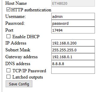

config of my ETH8020 (firmware v8):
board configuration.JPG (30.6 KiB) Viewed 2679 times

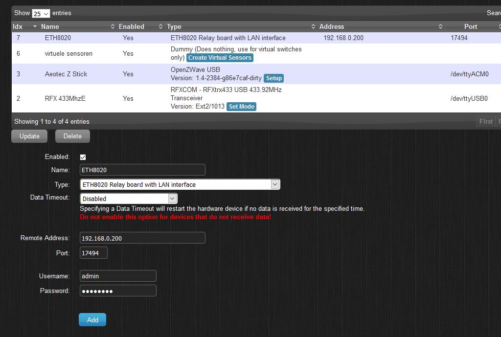

hardware config Domoticz:
could use a bit of help: what I am doing wrong?

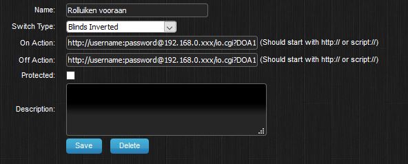

I'm using the ETH 8020 to open/close the roller shutters (every output is attached to a RF-transmitter which sends a signal to a group of shutters)
I created some virtual switches in Domoticz
and in the ON-action and OFF-action I'm working with a JSON URL.
eg:
http://username:password@ipETH8020/io.cgi?DOA14=15
where username and password are the credentials for your ETH8020 (defined in the config page of the ETH8020)
and where DOA14=15 generates an puls of 1,5sec on the 14th output from the ETH8020
you can find more about JSON URL's here: https://www.domoticz.com/wiki/Domoticz_API/JSON_URL%27s
you can find more about specific instructions for the ETH8020 in the manual
BTW This does the trick for me but I think there has to be an easier way (adding in hardware...?) but I didn't found it yet.

Hi heistje, i am juergen from germany.Under Domoticz Hardware, you must change the port to 80 in the Field.
By my older Domoticz Version 2.2x i must downgrade the FW of ETH8020 to V6 , now I have V7 and Domoticz 3.7 last stable, and I see you have V8.
Change the Port only in Domoticz. I had the theme Problem. Sorry for my bad english

Juergen,
You're my hero!
changing the port into 80 did the trick!
