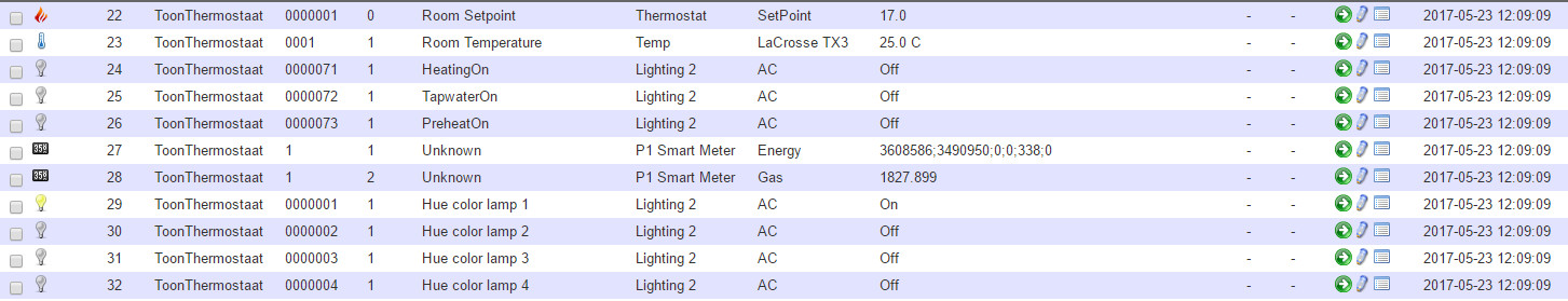

i do not understand a few things in this topic
mAiden88 wrote:First things first.. Example from Toon API will be show the current temperatuur. If we get that on Domoticz, we can go on!
This is already in the toon API for a very long time in my opinion:
All these devices I see everyday in Domoticz V3.7450
As far as I know these devices and values are coming via the API since there is no longer a "toon op afstand".
Or am I wrong?
But how do I get these values then? They are real time as far as I can inspect.
I hope one of the developers can give us an update about the state this API is in.
This evening I will setup a Raspberry and see if I can get toon working on that one.
I will keep you informed
Best regards Bert

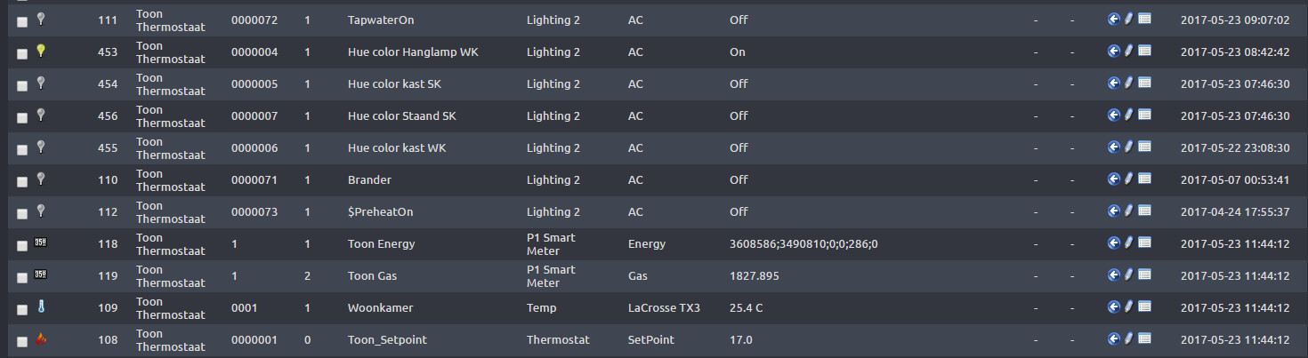

We don't really know why for some people it's still working and for others ir doesn't. It seems you are one of those people that still can connect to Toon.
I know that during the change in March, I did do some re-adjusting in Domoticz, and re-installed Toon. So it might be that that was the reason it doesn't work anymore.
bertbigb
Posts: 147
Re: TOON died within Domoticz
Post by bertbigb »
Could do it even faster since I have remote access
Toon devices on Raspberry.jpg (156.74 KiB) Viewed 4444 times
This raspberry has never had contact with Toon op afstand before.
I just enabled the hardware and all the devices came up.
For me this is prove that the API is working already
Best regards Bert

bertbigb
Posts: 147
Post by bertbigb »
EdKo66 wrote:We don't really know why for some people it's still working and for others ir doesn't. It seems you are one of those people that still can connect to Toon.
The only one who can tell is I think gizmocus. Probably you have to get in contact with him via a PM
Best regards Bert
