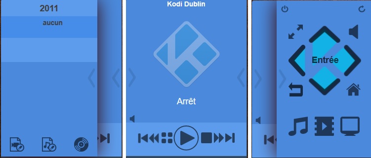

A Kodi widget would be nice, something like this: http://3.bp.blogspot.com/-hn9QvlyWj-Q/W ... uttons.jpg
