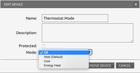

Rob, can you add these two new device types to Dashticz
Thermostat mode selector. There is four different mode 0 = Off, 1 = Heat (Default), 2 = Cool, 3 = Energy Heat;
   "ActTime" : 1493975839,
   "ServerTime" : "2017-05-05 12:17:19",
   "Sunrise" : "05:01",
   "Sunset" : "21:41",
   "result" : [
         "AddjMulti" : 1.0,
         "AddjMulti2" : 1.0,
         "AddjValue" : 0.0,
         "AddjValue2" : 0.0,
         "BatteryLevel" : 255,
         "CustomImage" : 0,
         "Data" : "Off",
         "Description" : "",
         "Favorite" : 0,
         "HardwareID" : 4,
         "HardwareName" : "Razberry",
         "HardwareTypeVal" : 21,
         "HaveTimeout" : false,
         "ID" : "00001801",
         "LastUpdate" : "2017-05-05 12:16:43",
         "Mode" : 0,
         "Modes" : "0;Off;1;Heat (Default);2;Cool;3;Energy Heat;",
         "Name" : "Thermostat Mode",
         "Notifications" : "false",
         "PlanID" : "0",
         "PlanIDs" : [ 0 ],
         "Protected" : false,
         "ShowNotifications" : true,
         "SignalLevel" : "-",
         "SubType" : "Thermostat Mode",
         "Timers" : "false",
         "Type" : "General",
         "TypeImg" : "mode",
         "Unit" : 1,
         "Used" : 1,
         "XOffset" : "0",
         "YOffset" : "0",
         "idx" : "329"
   "status" : "OK",
   "title" : "Devices"

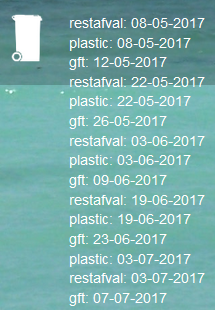

Great new functionality this Afvalwijzer (trash)!
However, I noticed that not all dates are displayed because in trash.js (the mijnafvalwijzer part) the object returnDates has the date as a keyname... When trashcollection on a given date has two different collections (for instance 'restafval' and 'plastic') only the latter of these two is added to the object...
Bit confusing: for some mondays 'plastic' is displayed and for other ones 'restafval'. At my place a monday is always 'restafval' and 'plastic' combined...
To solve this I've added a counter (called 'teller') which takes care of making the keys unique:
	if(service=='mijnafvalwijzer'){
		$.getJSON('http://json.mijnafvalwijzer.nl/?method=postcodecheck&postcode=' + postcode + '&street=&huisnummer=' + homenumber + '&toevoeging=',function(data){
			data = data.data.ophaaldagen.data;
			teller=0;
			for(d in data){
				if(typeof(returnDates[curr])=='undefined'){
					returnDates[curr] = {}
				var startDate = moment(moment().format("DD-MM-YYYY"), "DD-MM-YYYY");
				var endDate = moment(moment(Date.now() + 64 * 24 * 3600 * 1000).format("DD-MM-YYYY"), "DD-MM-YYYY");
				var testDate = moment(data[d]['date'], "YYYY-MM-DD");
				if(testDate.isBetween(startDate, endDate, 'days', true)){
					returnDates[curr][moment(moment(data[d]['date'], "YYYY-MM-DD")).format("YYYY-MM-DD")+teller]='<div>'+data[d]['nameType']+': '+moment(moment(data[d]['date'], "YYYY-MM-DD")).format("DD-MM-YYYY")+'</div>';
				teller++;
			addToContainer(random,returnDates);
In the original situation these moments are displayed (I've hacked a little to display more than 3 collection dates):
and with the counter:
Suits my needs a bit more... :mrgreen:
Regards,
Wizjos

wizjos wrote:Great new functionality this Afvalwijzer (trash)!
			teller=0;
			for(d in data){
				teller++;
In the original situation these moments are displayed (I've hack a little to display more than 3 collection dates):trash1.PNG and with the counter:trash2.PNG
Regards,
Wizjos
Thanks, will fix this!

koowee wrote:Rob, can you add these two new device types to Dashticz
   "Sunset" : "21:41",
   "result" : [
         "AddjMulti" : 1.0,
         "AddjMulti2" : 1.0,
         "AddjValue" : 0.0,
         "AddjValue2" : 0.0,
         "CustomImage" : 0,
         "Data" : "Off",
         "Description" : "",
         "Favorite" : 0,
         "HardwareID" : 4,
         "ID" : "00001801",
         "Mode" : 0,
         "PlanID" : "0",
         "PlanIDs" : [ 0 ],
         "Timers" : "false",
         "Type" : "General",
         "TypeImg" : "mode",
         "Unit" : 1,
         "Used" : 1,
         "XOffset" : "0",
         "YOffset" : "0",
         "idx" : "329"
   "status" : "OK",
   "title" : "Devices"

Added in latest beta!
   "Sunset" : "21:41",
   "result" : [
         "AddjMulti" : 1.0,
         "AddjMulti2" : 1.0,
         "AddjValue" : 0.0,
         "AddjValue2" : 0.0,
         "CustomImage" : 0,
         "Data" : "Off",
         "Description" : "",
         "Favorite" : 0,
         "HardwareID" : 4,
         "ID" : "00001801",
         "Mode" : 0,
         "PlanID" : "0",
         "PlanIDs" : [ 0 ],
         "Timers" : "false",
         "Type" : "General",
         "TypeImg" : "mode",
         "Unit" : 1,
         "Used" : 1,
         "XOffset" : "0",
         "YOffset" : "0",
         "idx" : "329"
   "status" : "OK",
   "title" : "Devices"
Solar radiation, now Dashticz shows it as a switch
   "ActTime" : 1493976213,
   "ServerTime" : "2017-05-05 12:23:33",
   "Sunset" : "21:41",
   "result" : [
         "AddjMulti" : 1.0,
         "AddjMulti2" : 1.0,
         "AddjValue" : 0.0,
         "AddjValue2" : 0.0,
         "CustomImage" : 0,
         "Data" : "347.2 Watt/m2",
         "Description" : "",
         "Favorite" : 0,
         "HardwareID" : 9,
         "HardwareName" : "Dark Sky",
         "HardwareType" : "DarkSky (Weather Lookup)",
         "HardwareTypeVal" : 25,
         "ID" : "0",
         "LastUpdate" : "2017-05-05 12:14:53",
         "Name" : "Solar",
         "PlanID" : "0",
         "PlanIDs" : [ 0 ],
         "Radiation" : 347.19999999999999,
         "SubType" : "Solar Radiation",
         "SwitchTypeVal" : 0,
         "Timers" : "false",
         "Type" : "General",
         "TypeImg" : "radiation",
         "Unit" : 1,
         "Used" : 1,
         "XOffset" : "0",
         "YOffset" : "0",
         "forecast_url" : "aHR0cHM6Ly9kYXJrc2t5Lm5ldC8jL2YvNjEuNjM2NjUzJTJDJTIwMjMuNzg3MjA1",
         "idx" : "115"
   "status" : "OK",
   "title" : "Devices"
Thanks, now Dashticz shows correct mode!
There is also possibility to change mode In Domoticz. It can be done via device Edit-button. Can this feature also be implemented to Dashticz?

robgeerts wrote:Added to latest beta! Thanks!
Although I've changed it a bit so today/tomorrow and the daynames shows in the correct language!
One minor change, the first letter of the day in uppercase :P
function addToContainer(random,returnDates){
   var returnDatesSimple={}
   var done = {};
   for(c in returnDates){
      for(cr in returnDates[c]){
         returnDatesSimple[cr] = returnDates[c][cr];
         done[c]=true;
   $('.trash'+random+' .state').html('');
   var c=1;
   Object.keys(returnDatesSimple).sort().forEach(function(key) {
      var date = moment(key).format("DD-MM-YYYY");
      var currentdate = moment(Date.now()).format("DD-MM-YYYY");
      var tomorrow = moment(new Date()).add(1,'days').format("DD-MM-YYYY")
      var nextweek = (moment(new Date()).add(6,'days').format("DD-MM-YYYY"))
      if(date == currentdate){
         returnDatesSimple[key] = (returnDatesSimple[key]).replace(date, lang['today']);
      else if(date == tomorrow){
         returnDatesSimple[key] = (returnDatesSimple[key]).replace(date, lang['tomorrow']);
      else if(date <= nextweek){
	 	returnDatesSimple[key] = (returnDatesSimple[key]).replace(date, moment(moment(date).format("DD-MM-YYYY")).locale('nl').format("dddd"));
		returnDatesSimple[key]= returnDatesSimple[key].charAt(0).toUpperCase() + date.slice(1);
      else {
         //console.log(date)
      if(c<=4) $('.trash'+random+' .state').append(returnDatesSimple[key]);
      c++;
   var done = {};
         done[c]=true;
   var c=1;
      else {
         //console.log(date)
      c++;
Maybe captalize the first letter of papier, restafval and plastic and change gft to GFT?
Blah blah blah
