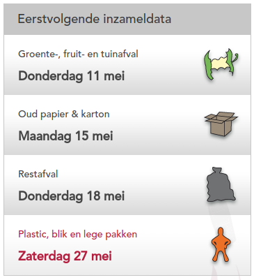

How can i extract a JSON output url?robgeerts wrote:TRASH CALENDAR (DE AFVAL APP)
WARNING: Only DeAfvalApp is working.
If anyone can provide me a JSON-output url of other services, send it to me
(With example zipcode)
I already have url's for:
Recyclemanager
MijnAfvalWijzer
Wil fix those asap so you dont need LUA-scripts
I want to extract it for you from http://inzamelkalender.hvcgroep.nl/
- mvveelen
- Posts: 710
- Joined: Friday 31 October 2014 10:22
- Location: Hoorn, The Netherlands
Re: Dashticz v2.0, custom positioning and multiple screens
+1clubeddie wrote:How can i extract a JSON output url?robgeerts wrote:TRASH CALENDAR (DE AFVAL APP)
Recyclemanager
MijnAfvalWijzer
Or rather... + 1000

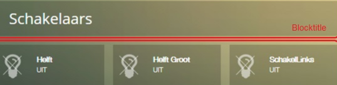

An easy question... how can add a blocktitle like "Schakelaars woonkamer" ?
- Schermafbeelding 2017-05-04 om 20.53.00.png (242.09 KiB) Viewed 2339 times
