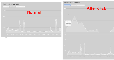

Secondly if I open the graphs of a energy button it opens fine but if I choose day/month/year the graph has some strange behaviour.
With every click on the buttons the graph adds another part to the graph.

sonar wrote: Secondly if I open the graphs of a energy button it opens fine but if I choose day/month/year the graph has some strange behaviour.
I believe all the graph's have that problem. Noticed it earlier today.

robgeerts wrote:I hate the graph functionality of Domoticz! ;)
Its just not logic... but will check things again...
The graphs placed on the screen are working as expected. The problems only occur on the popup when clicking the energy buttons.
Also with wind an room temp, as far as I can see, and my up/download and ping graphs, but those are not important
