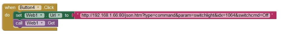

I am using the API calls described here:
https://www.domoticz.com/wiki/Domoticz_API/JSON_URL's
I made a button and when clicked it should send the command to Domoticz.
Here is the block program:
[img]
[/img]
When I enter this command in a web-browser it works.
So the command is ok but the communiaction from within app-inventor is not.
Any ideas ???
Luc

Your port to Domoticz looks wrong - should it not be 8080?

theolsen, you are absolutely right that 8080 is the standard port
However in Domoticz in:
/etc/init.d/domoticz.sh
you can alter the number of the port.
As I suspected that there could be an issue with App-Inventor and port 8080 I changed the port
number in Domoticz. Did not work. So I altered it back.
Luc

Maybe the problem is that the app-inventor works in the cloud and thus needs to use a publix/external Domoticz address and not the home lan network address?

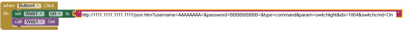

Found it.
The code should be as in the blocks example shown here:
[img]
[/img]
The IP adress should not be the local IP adress but the adress used to access Domoticz over the internet.
Then as the blocks show you need to invoke your username and password however they need to be base 64 coded.
The above blocks code works flawlessly.
Now I can devellop my own app. And so can you.
