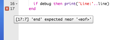

This is the script I'm using
local RainTextIDX = 113   -- your domoticz text device
debug = false -- enable or disable debug output
tempfilename = '../var/packages/domoticz/scripts/lua/tmp/Rain.tmp' -- be sure this is in the correct map, and give it chmod 0666
totalrain = 0
rainlines = 0
function IsItGonnaRain( minutesinfuture )
   url='http://gpsgadget.buienradar.nl/data/raintext/?lat=51.86&lon=4.41' -- this is important!! change the lat and lon to your needs!!
   if debug then print(url) end
read = os.execute('curl --connect-timeout 5 -s -o '..tempfilename..' "'..url..'"')   file = io.open(tempfilename, "r")
   while true do
      line = file:read("*line")
      if not line then break end
      if debug then print('Line:'..line) end
      linetime=string.sub(tostring(line), 5, 9)
      if debug then print('Linetime: '..linetime) end
      linetime2 = os.time{year=os.date('%Y'), month=os.date('%m'), day=os.date('%d'), hour=string.sub(linetime,1,2), min=string.sub(linetime,4,5), sec=os.date('%S')}
      difference = os.difftime (linetime2,os.time())
      if ((difference > 0) and (difference<=minutesinfuture*60)) then
         if debug then print('Line in time range found') end
         rain=tonumber(string.sub(tostring(line), 0, 3))
         totalrain = totalrain+rain
         rainlines=rainlines+1
         if debug then print('Rain in timerange: '..rain) end
         if debug then print('Total rain now: '..totalrain) end
   file:close()
   averagerain=totalrain/rainlines
   return(averagerain)
function round(num, idp)
   local mult = 10^(idp or 0)
   return math.floor(num * mult + 0.5) / mult
   minuten=15
   RainPrediction = IsItGonnaRain(minuten)
   RainmmHour=10^((RainPrediction-109)/32)
   if (RainPrediction > 20  ) then
      verw = 3
      RainPredictionText=('('..round(RainmmHour, 1)..' mm) regen verwacht!')
      verw = 2
      RainPredictionText=('Voorlopig blijft het droog!')
   commandArray[2] = {['UpdateDevice'] = RainTextIDX .. '|0|' .. tostring(RainPredictionText)}
return commandArray
At the moment the script is spewing out errors '2017-04-29 19:20:01.901 Error: EventSystem: in Regen Verwacht: [string "local RainTextIDX = 113 -- your domoticz te..."]:13: attempt to index global 'file' (a nil value)', so I stopped it for now.

jvdz
Posts: 2441
Domoticz version: 4.107
Re: Is it gonna rain within the next X minutes?
Post by jvdz »
Looks line you have line 11 at the end of line 10... change that to:

Thanks. :) Guess I did make some error :)
But still there is this error:
2017-04-29 21:28:00.219 Error: EventSystem: in Regen Verwacht: [string "local RainTextIDX = '113' -- your domoticz ..."]:17: 'end' expected (to close 'while' at line 13) near
Screen Shot 2017-04-30 at 17.54.09.png (17.69 KiB) Viewed 2512 times
