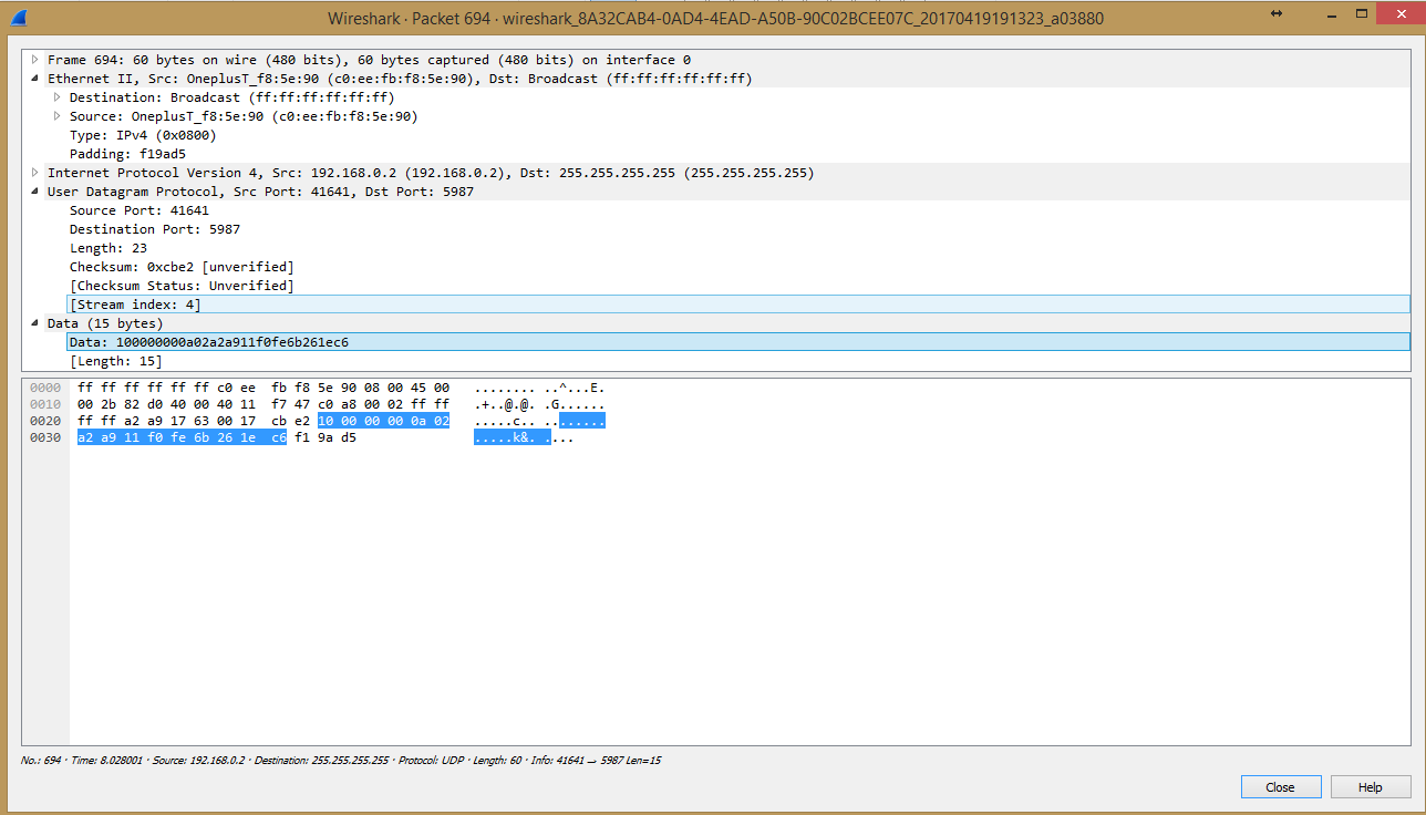

After sniffing my network yesterday. (With wireshark) I've noticed that the app of "Mi-Light" send everything towards the broadcast address.
I'll try to compare the commands (or add some screenshots of them)

Attachment 1:
Is the UDP "Data" that my cellphone send towards the "ipbox" via the broadcast address.

It seems that the UDP data is totally diffrent then the one that I find on the interwebs.
It'll take some time for me to figure out what the difference are with the FUT038, Its been a while that I've used wireshark (and I still need to learn the ways how "Mi-light" transfers it data.
