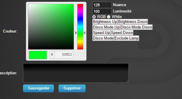

I use the Mi-Light with 4 RGB ledstrips.
In Domoticz I go to HARDWARE and add the "Limitless/AppLamp with LAN interface"
Then I see in Devices 5 new devices.
The 4 zone's, 1 group and the one for changing colour or mode.
The problem is, they are for RGBW and don't work for me.
I delete the RGBW device's.
I set the mode to RGB
Then i only see the colourchange device, but not the other four device's
When I set the mode back to RGBW all devices come back.
How to get the devices working with RGB?

Just got my first Mi-light set.
What a shame !!!!
The widget is not complete there is no slider to set color and intensity like zwave ?
How to solve this ?

deennoo
- Posts: 784
- Location: Bordeaux France
Re: Mi-Light / LimitlessLED / Applamp
Intégration with dimmer is really great.
Is there a way to get the night mode without script or Android app ?

deennoo
- Posts: 784
Just update with beta 2.4237 !
Great Job !! thx very much !
Just night mode is missing !
Looks like you put the disco script on domoticz code?
How to had more effects and rolling menu ? with just Effect on and Effect Off ?
