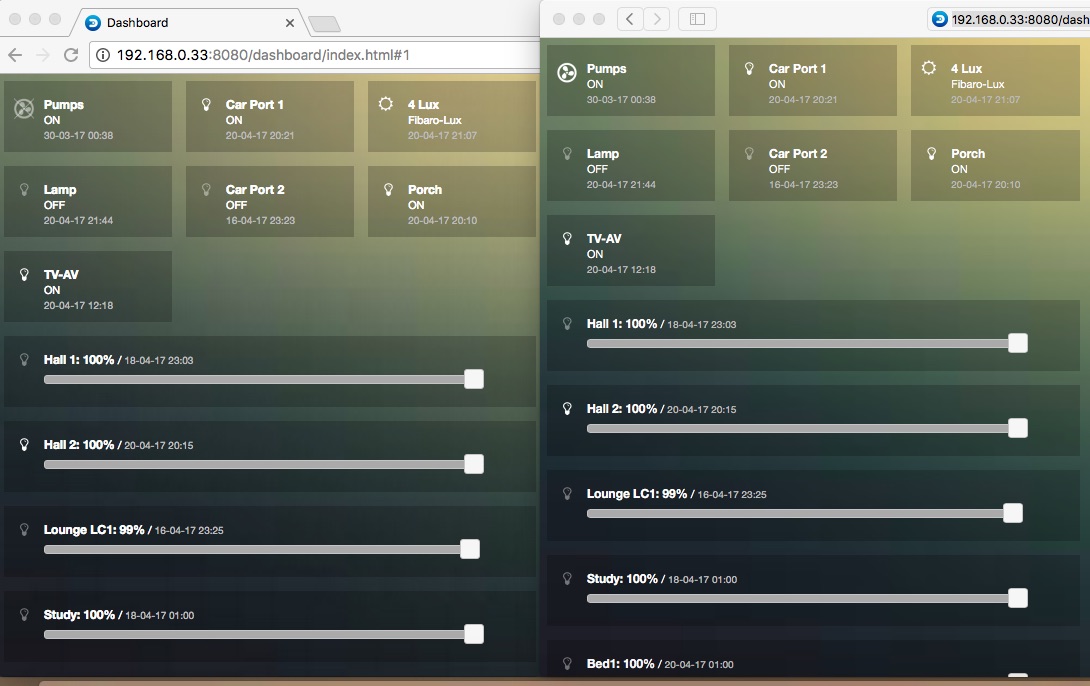

Btw is there a possibility to change the layout of the sliders to "top-bottom" instead of "left-right".
