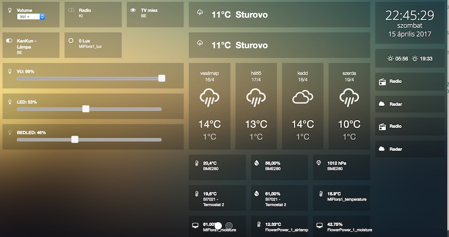

latest version, I am trying to enable multiple screens:
//if you want to use multiple screens, use the code below:
var screens = {}
screens[1] = {}
screens[1]['background'] = 'bg3.jpg';
screens[2] = {}
screens[2]['background'] = 'bg3.jpg';
screens[2]['columns'] = [4,5,6]
...result:
Screen Shot 2017-04-15 at 22.45.20.jpg (87.74 KiB) Viewed 2481 times
On the first page weather block at the top is duplicated + buttons are on the right are duplicated. Second screen looks fine.
It would be great if someone would write a guide about multiple screens, blocks and columns.
I am trying to create custom screen with custom switches. With current information it is pretty hard, but I am keep trying.
robgeerts

hpapagaj wrote:Robert,
var screens = {}
screens[1] = {}
screens[2] = {}
...result:
y
Could you post your config.js?

If you have 2 min for me:
It is possible to:
-first page use_favorites = true,
-second page custom title = "Heating / Cooling", and custom switches with their IDX (thermostat, temp sensors)
If you have a little time could you please post a config for this case?
Also I asked yesterday to show RSS feed somewhere, I was unable to make this work.

Unfortunately,
You cannot use the automatic-function on screen 1 and some custom devices on screen2...
You jave to define blocks, columns and screens if you want to use multiple screens.
The wiki explains a lot.
Further, if you want to use rss, you can define one as:
blocks['news_2'] = {}
blocks['news_2']['feed'] = 'http://feeds.feedburner.com/tweakers/nieuws';
And use the key 'news_2' when defining the blocks in a column.
Example:
var blocks = {}
var columns = {}
columns[1] = {}
columns[1]['blocks'] = ['news_2']
columns[1]['width'] = 5;
One tip, I can see your config.js is from a very old version, try starting overnew bij copying config-default.js to config.js

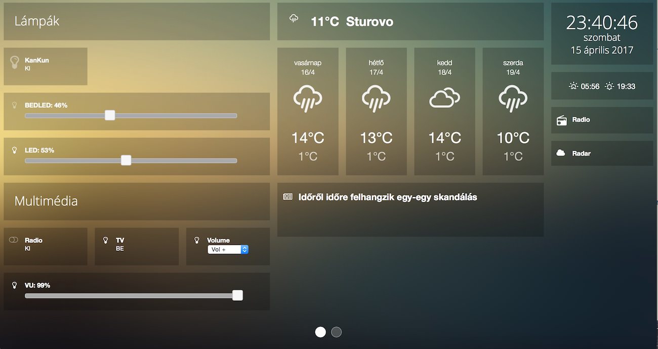

robgeerts: sometimes you need only a little "kick" from the right people...thanks!!! I am on it, and it works! ;)
Screen Shot 2017-04-15 at 23.40.42.jpg (86.58 KiB) Viewed 2451 times
One more question: in v1 of Dashticz we combined devices like Temp + Humidity + Baro into one block, but in v2 they are now separated into 3 blocks.
I tried to modify addHTML to true (main.js, around line 700), but it does not helped.

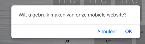

- I see a popup coming I think is from buienrader. This appears on a regular bases. Clicking OK or Annuleer does not mather. Happens on iPad and PC. (See attached screenshot)
In config.js change buttons.buienradar to read:
buttons.buienradar = {width:12, isimage:true, image: 'http://api.buienradar.nl/image/1.0/RadarMapNL?w=285&h=256', url: 'http://www.weeronline.nl/Europa/Nederland/Son/4058667'}
