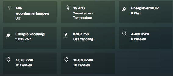

I find a typo
Schermafbeelding 2017-04-15 om 16.28.10.png (55.67 KiB) Viewed 1893 times
"Energie vandaag" is on the place of the kWh
Gerard

gjaa wrote:I find a typo
Fixed in latest version!

Posts: 38
Joined: Thursday 12 February 2015 6:59
Re: Dashticz v2.0, custom positioning and multiple screens
Post by gjaa »
My doorcontact's state never change, it's always open
Schermafbeelding 2017-04-15 om 19.19.26.png (19.11 KiB) Viewed 1844 times
Here is the setting

Gerard

robgeerts
Posts: 1273
Domoticz version: 3.7067
Post by robgeerts »
gjaa wrote:My doorcontact's state never change, it's always open
