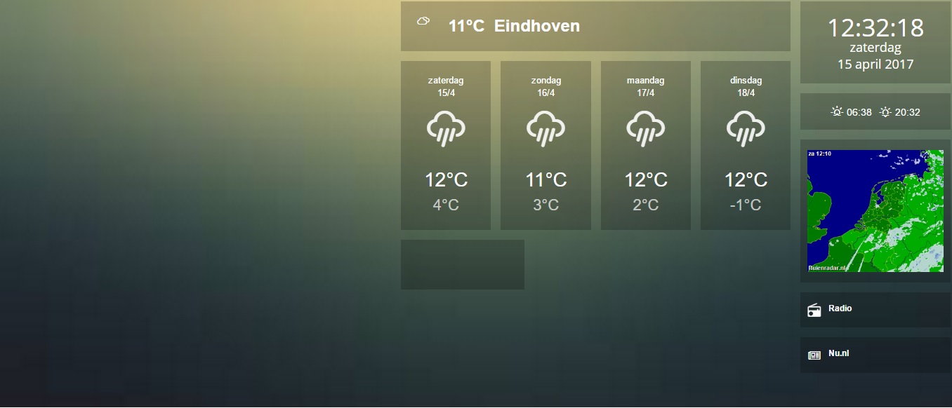

Post by b00n »
Hellow,
is anyone having the same issue i'm only getting emty boxes for my switches ?

Post by robgeerts »
What is the content of your config.js?
And do you get any error in console? (f12)

Post by EdwinK »
b00n wrote:Hellow,
Looks like there is an error in your CONFIG.js. Check your IDX's

Post by freakshock »
b00n wrote:Hellow,
If you share your config.js we van help you better :)

Post by b00n »
Do i miss something?
CONFIG.js
(3.6 KiB) Downloaded 65 times
