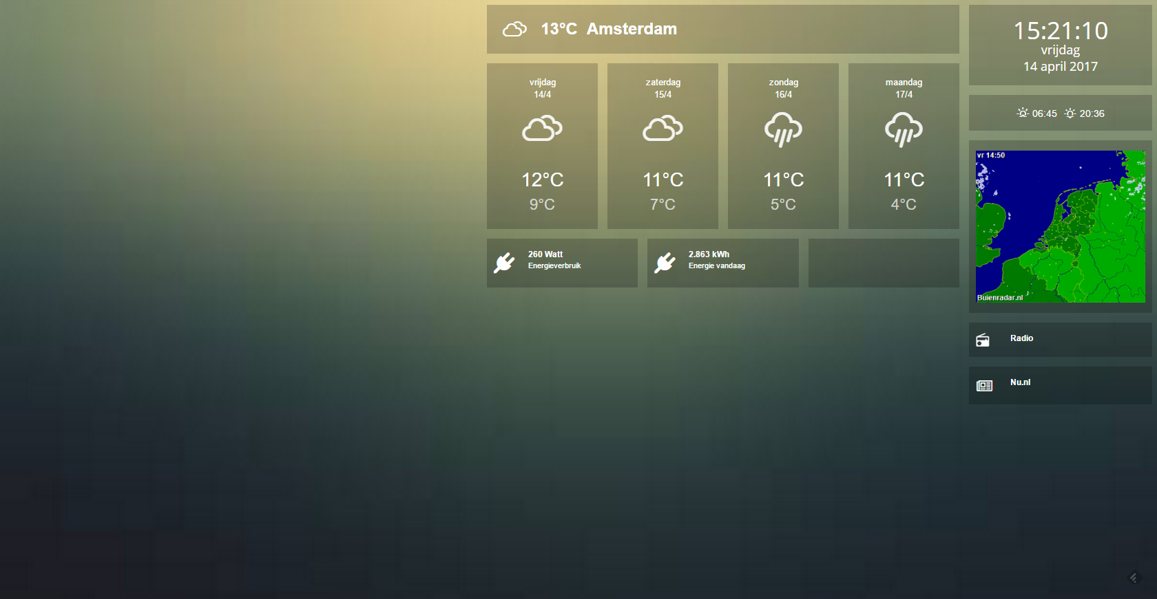

With version dashboard-master-f91dc326e9df83cfab11e9c6e58c5af384fa4298 I get the error in my attachment.
In a version from 2 days ago I do not have this problem, with the exact same settings in config.js.
Can you also look into that Rob, or is this a mistake somewhere on my part?

Yes, this one:
jquery.min.js:4 Synchronous XMLHttpRequest on the main thread is deprecated because of its detrimental effects to the end user's experience. For more help, check https://xhr.spec.whatwg.org/.
