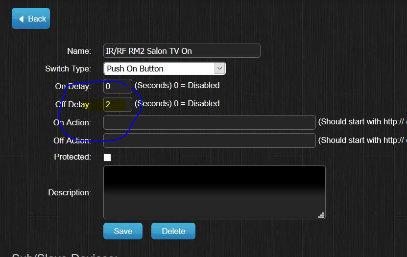

My question is (and it's probably a silly one), but what is the easiest way to make the switches that operate the RM's commands "momentary" as far as their status is? ie. "press on, command is transmitted, status returns to off"?
I know I could do a little script to be triggered everytime one is turned on to turn it off again, but I'm hoping there is a simple "once only" way to apply it to all RM2 commands.
Cheers,

there is no way to do that in oneshot for all devices.
On the next release, you should be able to put device off by using Domoticz param:
markk

zak45 wrote:Hi,
Fantastic!!
