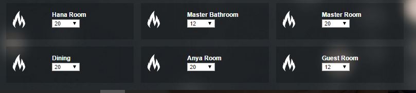

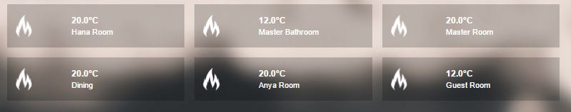

just noticed in that my setpoint devices are not showing up at two devices in the Dashboard
Setpoint Device 2.JPG (21.78 KiB) Viewed 2854 times
Setpoint Device 1.JPG (21.2 KiB) Viewed 2854 times

ddahya wrote:just noticed in that my setpoint devices are not showing up at two devices in the Dashboard
Aren't they also positioned in the left column?
Could you send me a complete screenshot?
And, if possible, the complete (all devices) json-output from domoticz, via PM?
Just sent you all the details via PM
